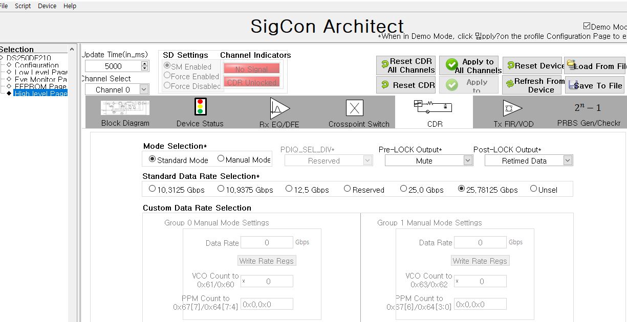

we are using SigCon to test DS250DF230.
What is the difference between pre-lock output and post-lock output in the image below?
we can't find it in the datasheet or programmer guide.

The "pre-lock" outputs pull-down determines the output type for the channel for the case when CDR status is not locked.
The "post-lock" outputs pull-down determines the output type for the channel for the case when CDR status is locked.
