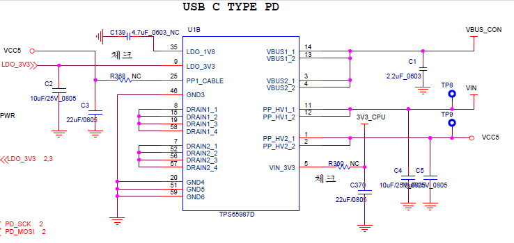

I am designing a power sink+source board using TPS65987D.
The mode I want to implement is 20V SINK Mode + 5V SOURCE Mode.
But, There is no FLASH on our board.
So I want to use the TPS76987D with the default settings.
First, I Try this Mode
My Board can receive 20V from TPS65987D.

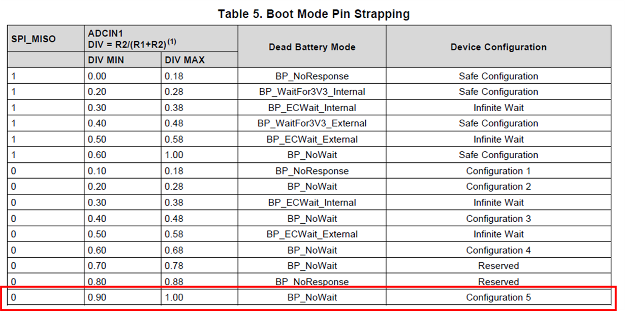

But, I Change Mode to Configuration 5…..
Board is not working. VBUS_CON=20V, but PP_HV1=0V

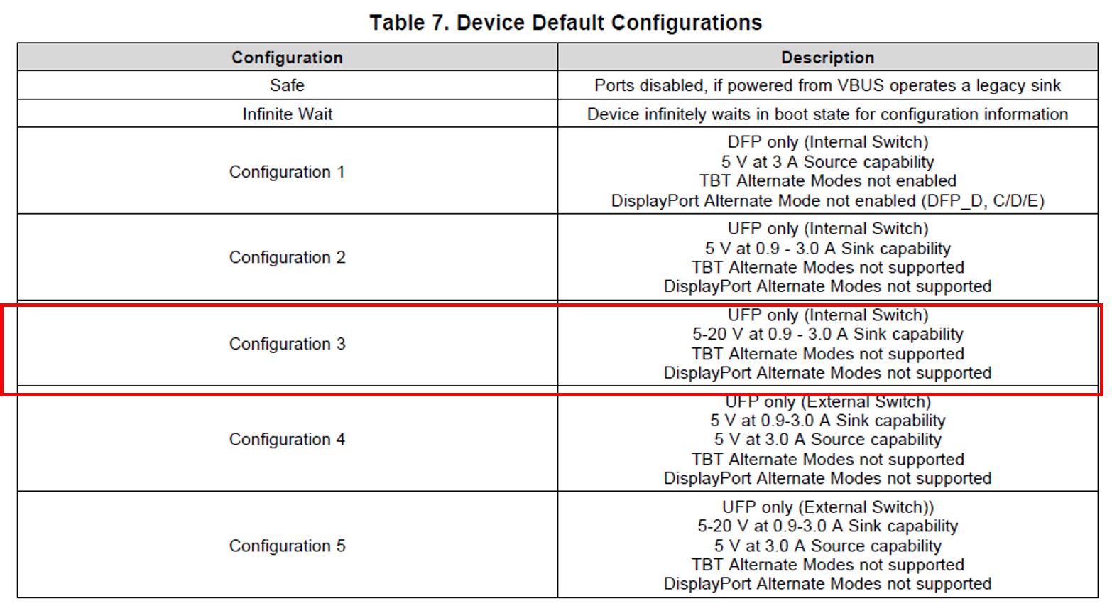

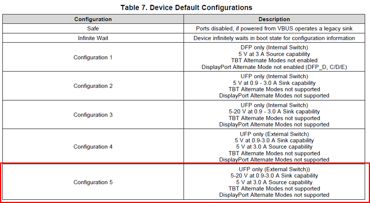

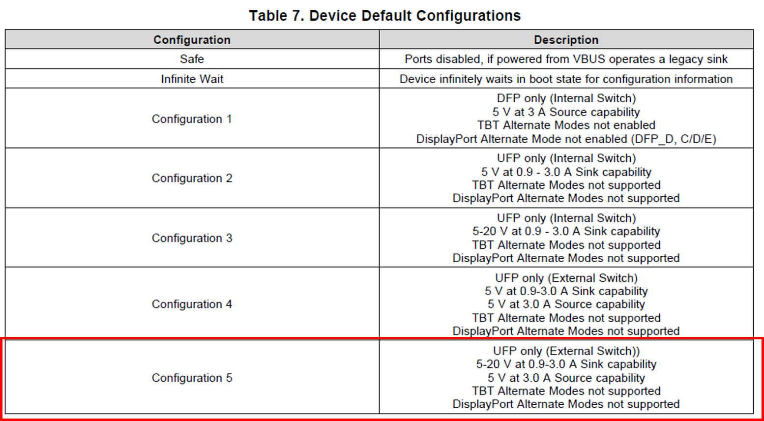

  1. What is meaning that “External switch” (Written configuration5 Description) ?
  2.  Can I implement 20V SINK Mode + 5V SOURCE Mode without FLASH ?

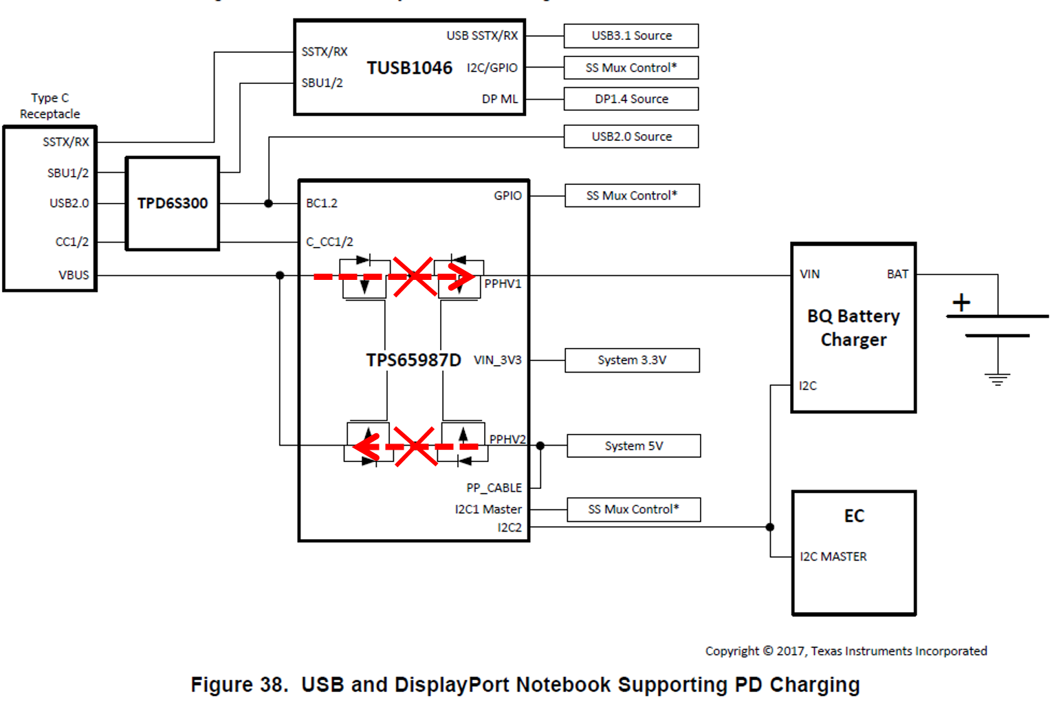

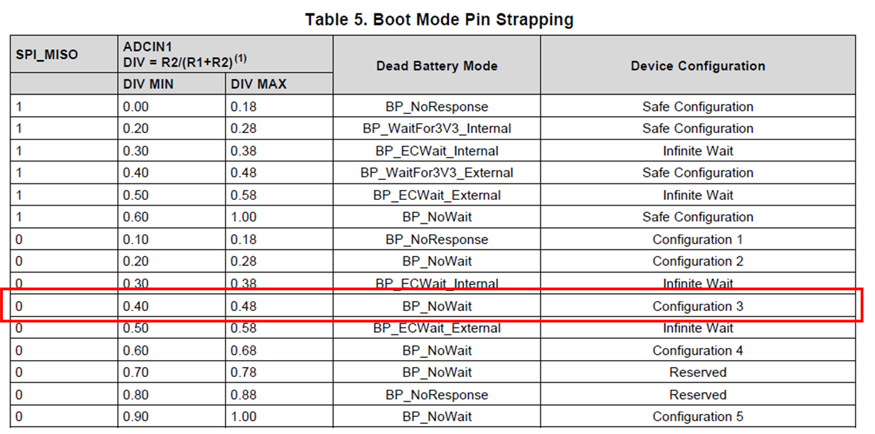

    There is the option to control a external power path instead of using the internal power paths. You can use the TPS65987EVM as reference. Based on your schematic capture though, you should be using configuration 3 which is capable of sinking up to 20V using the internal power path.
    Have you tried negotiating a 5V source contract using configuration 3?

    I can get 5V (PPHV1 OUT) using configuration 3.
    (Connect 5V only Charger)
    In case configuration 5(external switch), Can't I use Internal power paths?

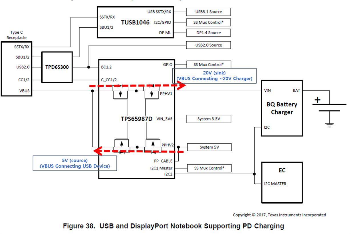

    I want to implement it like below Scheme without FLASH.
    Which setting should I use?
    Can it be implemented?
    Thanks for the kind reply.
    I look forward to your quick reply. Thank you.
    Yes you should be able to implement the two internal power paths using configuration 3
    I haven't solved it yet.
    As mentioned in the first question, 5V Source Mode did not work when running with the 3rd setting.
    What's the problem?
