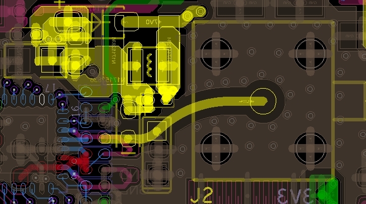

  • Hi Sally,
    Attached customer layout picture and file, please also help to review. thanks.
    HW_C-CAM-IC005A-POWER_PCB_1V0_A-20200807.brd

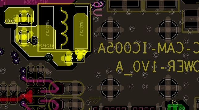

  • Hi Sally,
    I also attched customer layout picture of POC circuit, please check.

  • Hi Betty,
    it's difficult to see from those snaps shots, so I will ask you:
    1. Did they route RX+ and RX- with differentially and loosely coupled (S = 3W) 100ohm ±10% traces. Make sure they terminate RX- near the connector and switch RX+ to 50ohm single-ended trace.
    3.Spacing with adjacent ports should be greater than 3-5 times the width of the trace to avoid mutual coupling.
    4.Place the AC coupling caps close to the device pins. Make sure to add anti-pads underneath the AC coupling caps for impedance matching. The footprint for the caps should be coupled with ground.
    5.Place the first PoC inductor/ferrite bead orthogonally to the RX+ traces, barely touching the trace instead of crossing through the trace. Add anti-pads underneath the footprint to ensure consistent impedance. Make sure RX+ traces can carry PoC current without significant temperature rise.
    6. Can they probe their SER board to make sure they are getting the correct voltages at the power pins?
    Sally

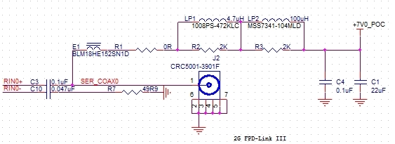

  • Hi Sally,
    I will feedback to customer.
    one more question. for current POC circuit, if the input is 10V, current need 500mA, does below POC circuit can handle this requirement? and how to select inductor?
  • Hi Betty,
    I was not able to find the d/s for the ferrite beads, but you should make sure that the saturation current of those parts are above 500 mA. You can follow our "2G" PoC example on which inductor values to use and what the SRF frequencies are.
    Sally
