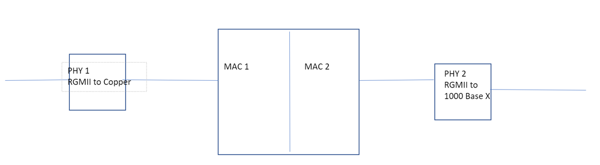

I have 2 DP83869 PHYs in between an FPGA which holds a gigabit ethernet IP core.  I have 1 PHY hardware strapped RGMII to copper and the other is strapped RGMII to 1000Base-X.  I have confirmed that the strapping is correct on each PHY, and I have a UART module which prints out the MAC and PHY register values, which also confirms that the PHYs strapping is valid.  Inside the FPGA, I have an FSM which configures mostly the MAC registers, but I also write to register 0x18 (LEDS_CFG1) to get the ethernet jack LEDs working, which they seem to be.  I have a solid link light and a blinking activity light when an ethernet cable is attached.
My issue is that I get no evidence of RGMII data passing between the MAC and PHY.  I also get no valid speed, duplex or link up when reading register 0x11, even when my host PC sees the link as a valid gigabit link.  I have verified all power lines, resetn is high and the 25Mhz clock.
How would I go about debugging this, and how would I determine where the issue with my system is? I am aware that this may be an issue with the MAC, but I am trying to explore all possible issues with this.

  • Hi Raymond,
    Can you please provide the register information for register 0x0000-0x001F, 0x006E, 0x01DF when the device is in the faulty state? You mention you are testing multiple PHYs, which PHY is showing the link errors? A block diagram of the setup you are using to test would also be helpful.
    Justin
  • Sure,

    Unfortunately, we are not able to read registers above 1F in our current configuration.  Are registers 6E and 1DF critical to getting this working?
    This PHY is the one that is strapped for RGMII to copper where I have an ethernet port connected to it.  After clearing the first PHY/MAC interfacing issues, I would imagine the second would be a similar fix.
