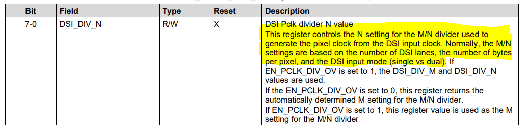

I'm using UB941AS in DSI Reference Clock Mode, 0x56[1:0]=00, I would like to know the relation between the input clock (DSI Clock) and the output when I use M/N dividers.
In the datasheet, this equation below below is mentioned but it doesn't contain M and N:
In the description of DSI_DIV_N and DSI_DIV_M, the equation is not mentioned:
