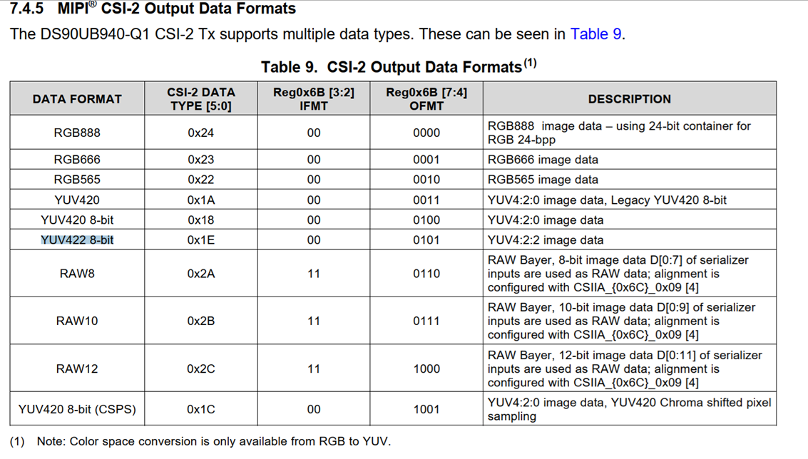

Dear team,
There is a note below the picture. I don't understand what it means. That means if the serializer is RGB format, the 940's output must choose YUV format? In my understanding we can choose any format in the table, no matter what mode the input format is. Could you please help explain this note?
