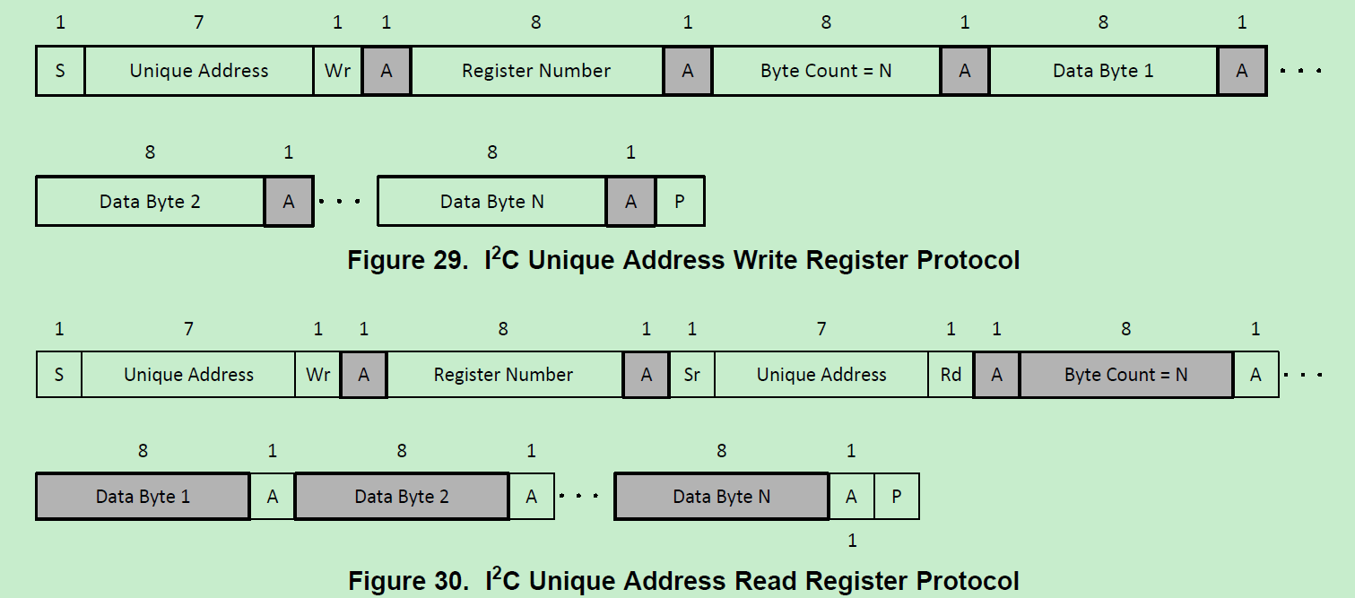

  • 0x51 register can be modified even if the device is running. You can change its value directly and no need reboot from internal RAM or external EEPROM as long as the correct I2C address is set.
    More details about how to write the value through I2C, you can take TPS65988 datasheed as reference (Page 41). Below is the chart of general I2C protocol:
    Please be careful that the protocol may have distinctions among different I2C adapters.
    Thanks.
