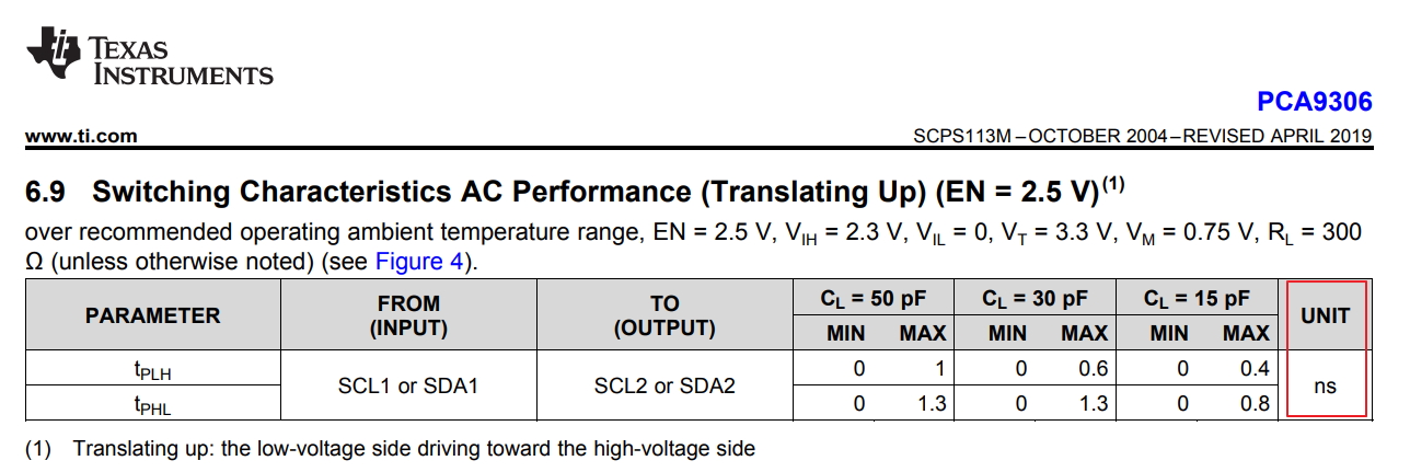

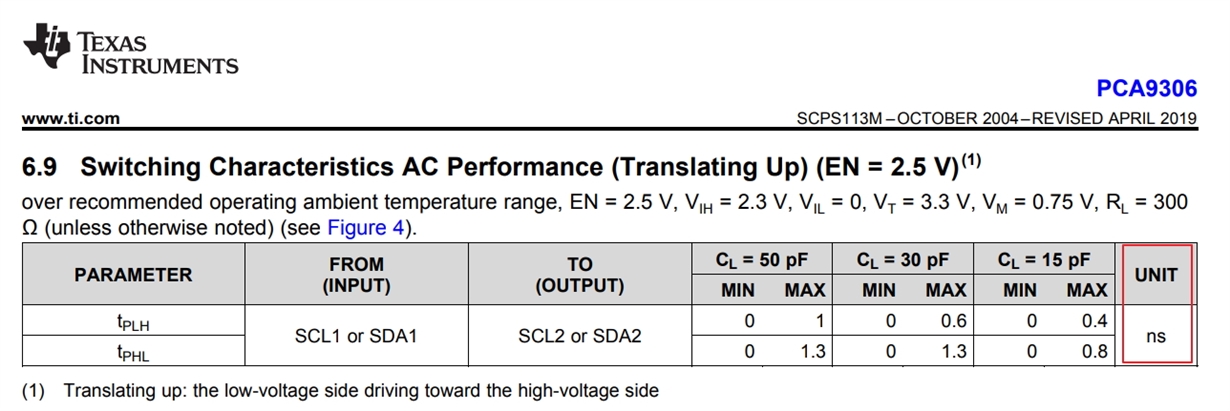

Hi Team,
As shown below, Is there an unit error in red box ? Is 『 microseconds 』 correct ? thanks.
P.S.
I think the unit is not nanoseconds,because I measured results were similar TCA9617B Delay, between 30ns~150ns.
