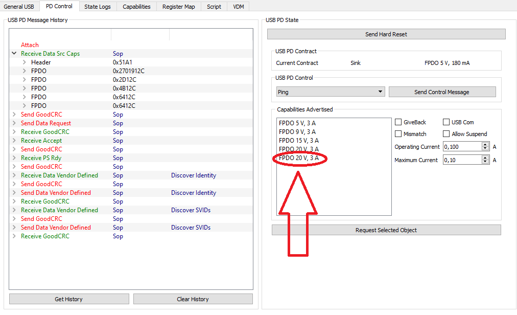

We've got the TPS25750EVM and would like to use them as 100W PD source only. We connected a "5A" USB cable but with our PD test tool we get only 5V/9V/15V/20V 3A capability from TPS25750, nor 20V 5A capability. Of course, we selected the 20V/5A capability in the GUI. Is there an additional setting necessary?
By the way I think we found an error in the instructions:
In the eval user guide you write under "5 Setting up the TPS25750EVM as a High Voltage Source":
"Next, use the jumper provided on J3 and shorting pins 2 and 3 together." and  "If you would like to source more the 3A from LM3489QMM to the TPS25750, then you will need to add a 0 Ω
resistor to R2." I think, R2 should be in parallel to J3 pins 2 and 3 but R2 is in parallel to pins 1 and 2.
