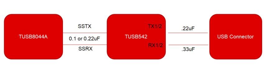

Hi, Team we are using  TUSB 542  for making  connection between the USB type C connector and  TUS8044A hub downstream port/. As per TUSB 542  datasheet, i  should put  AC  coupling  capacitor on both  TX  and  RX pairs, as per the TUSB8044A  datasheet we need to AC  coupling capacitor on their  TX  line.
Please confirm only one capacitor on each pair is okay. How  we  should place  the  AC  coupling capacitor during  placement  .
    The hub datasheet is written assuming the hub is connected directly to the USB connector.
    When connecting between the TUSB8044A and TUSB542, AC coupling caps need to be placed on both the SSTX and SSRX. The AC coupling caps need to be 0.1uF or 0.22uF for both the TX and RX.
    Between the TUSB542 and the USB connector, caps are required on TX and optional on RX. For TX, it is recommended to be 0.22uF and for RX, it is recommended to be 0.33uF.

    Thanks for your reply. Which capacitor we should place near the HUB and which towards TUSB542.
  • Hi
    Please see the block diagram. The caps can be placed in the middle.
    David
