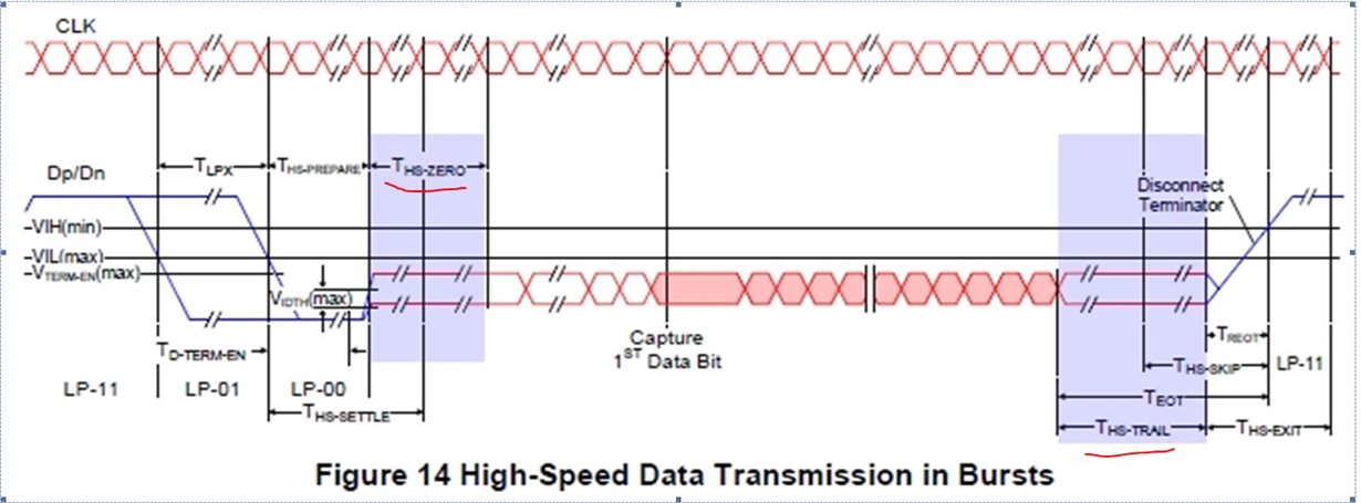

Dear BU engineer,
DPHY440 meets MIPI DPHY 1.1 compliant.
if MIPI input is a little different from DPHY 1.1 standard spec by customer encoding, Does IC work properly to regenerate DPHY signal ?
DPHY 1.1 spec : THS-Zero  is '0' & T HS-Trial is reverse of last data bit
customer encoding : THS-Zero is not '0' ,  THS_Trial is not reverse bit of the last data bit.
in below All other specs are same except THS-Zero and THS_Trial.
would you confirm that SN65DPHY440 IC does just re-driving as same as MIPI input even though THS-Zero and THS_Trial is not compliant with standard 1.1 spec  Or not ?
