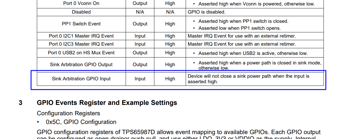

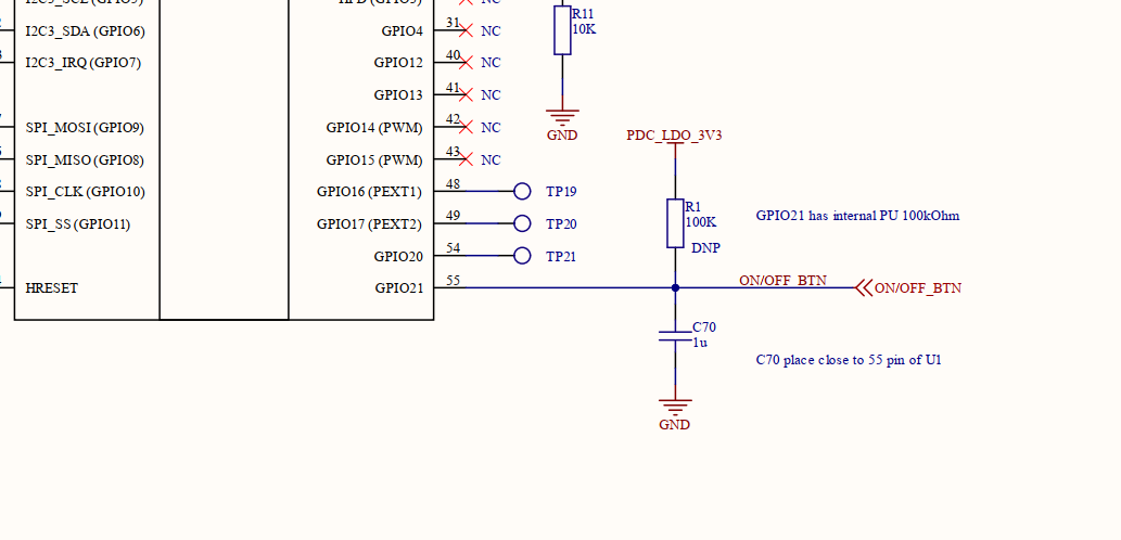

I used Sink Arbitration GPIO Input Event for control the internal power switch. I connected the external Rocker Switch to the GPIO21 of Power Delivery Controller (PDC). And I want to turn on/off the internal power switch of PDC use the Rocker Switch. But it doesn't work. The internal power switch of PDC stay open always. If I inverte this event, the internal power switch of PDC turn on when the Rocker Switch is "off"-position and turn off when the Rocker Switch is "on"-position.
My schematic:
