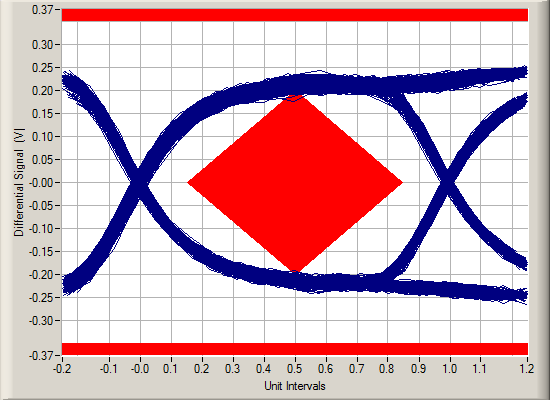

    But my lone bit pattern (LPB) test item is failed due to insufficient eye amplitude, are there any registers or compensation resistor can change the SATA driving strength?

  • Hi Norman,
    Unfortunately the SATA TX performance is fixed and there re no register available to help improve the performance here. It seems you will need to implement a redriver in your design. What is your board trace length on the state side? I can also try to review the layout to see if any improvements can be made.
  • Hi Malik,
    The SATA board trace is about 1500 mil, it's not too long but there is a high speed quick switch(QSW) place in the middle of SATA trace, it causes a little bit signal attenuation. We've tried to skip the QSW and got the pass result.
    we are planning to re-spin to optimize the board trace as short as possible, expect the short trace could cover the attenuation caused by QSW.
    Could you let me know TUSB9261 DEMO board's SATA trace length?
  • Hi Norman,
    The TUSB9261 Demo boards SATA trace length is ~450 mils.
