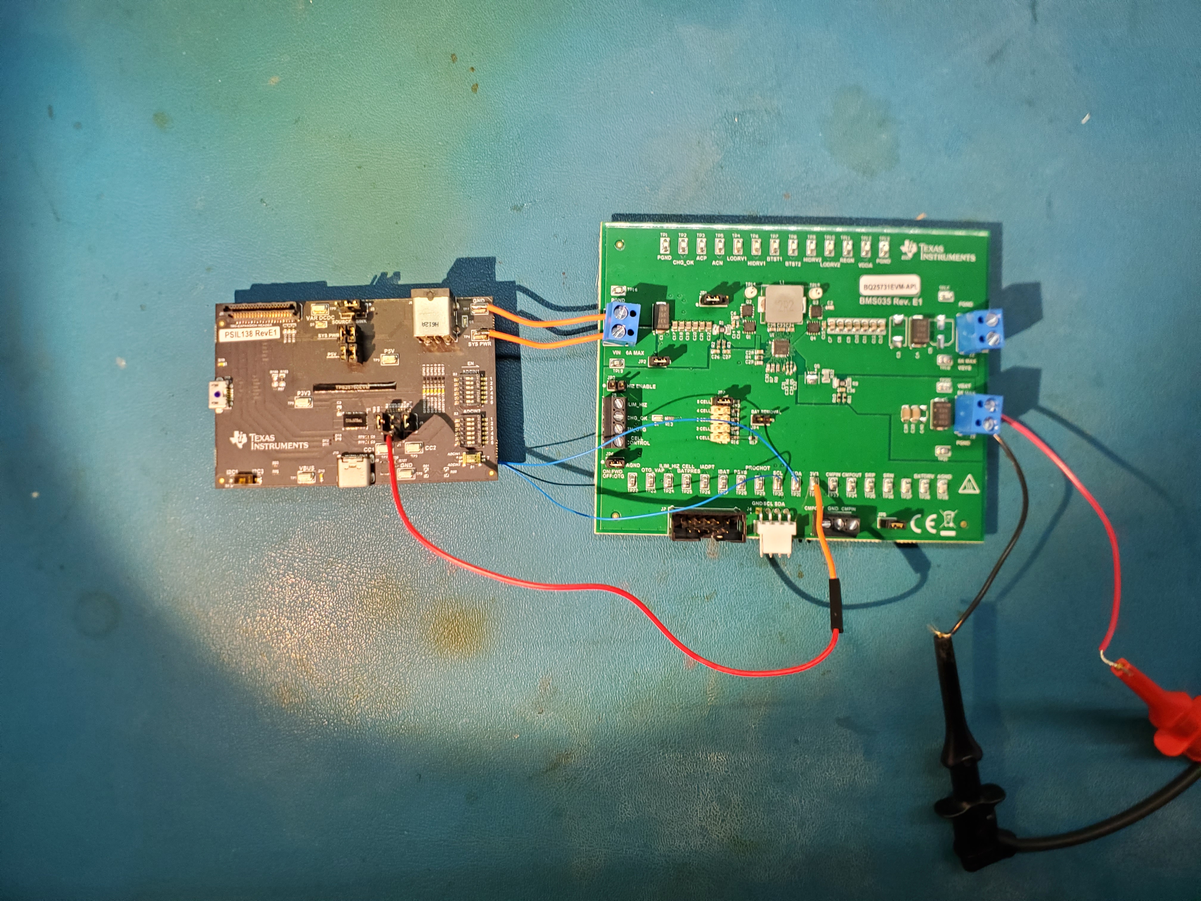

Here is their setup on the EVM boards:
- All jumpers default except
- BQ25731.J7->set to 5 cell
- TPS25750.J1->jumper removed and pin 3 attached to 3V3 on BQ25731(TP32)
- IC2 on BQ25731 (TP30,31) attached to TPS25750.J7 (pins10,8)
- Bench supply attached to BQ25731.VBAT screw terminals, set to 20VDC.
- BQ25731.VIN screw terminals attached to the TPS25750.SYS_POWER and GND TPs
They get the 3V3 from the BQ25731 over to the TPS25750 but the BQ25731.VIN screw terminals don't pass the 20VDC, even when I plug in a USB-C device to the TPS25750 that requests 20VDC. I'm wondering if they’re missing something on how the wiring and Vregs are connected or some sort of programming or boot-up they need to do to the BQ25731?
