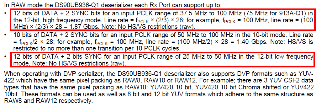

Part Number: DS90UB936-Q1
Hi Team,
In 936 RX MODE, it has RAW12 LF and RAW12 HF.
May I ask what the difference is? 12 LF means remove the LOW 4 bit in 16 bit data?
