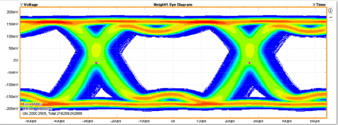

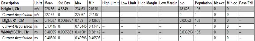

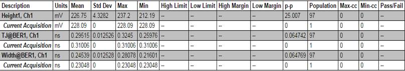

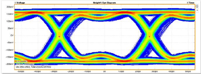

Below is two port's eye diagram. The eye height is about 200mV which is a little small. Do you know what factors will result in small height? Can I increase the height by changing registers?

    Sorry, I make a mistake. This eye diagram is measured on the 948's CMLOUT pins instead of 941's. When we increase the CMLOUT pins' terminal resistor(100ohm), the height increase a little.

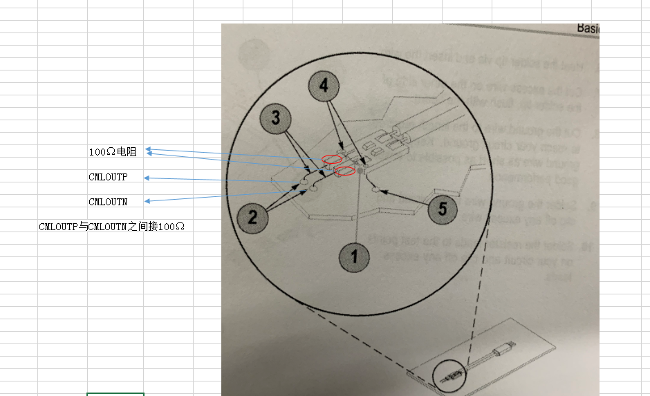

    They use the differential probe, and the probe information is as below,
    In addition, there is a 100ohm resistor on the differential probe, please refer to below red mark. If they remove these two resistors, the eye height increases from ~230mV to ~500mV. Could you please tell me whether we need to remove these two resistors when test eye diagram?

  • Hi Sherry,
    Are you following the CML circuit recommendations on Figure 48 and 49 on the 948's datasheet? there should not be to 100 Ohms in series when measuring CML.
