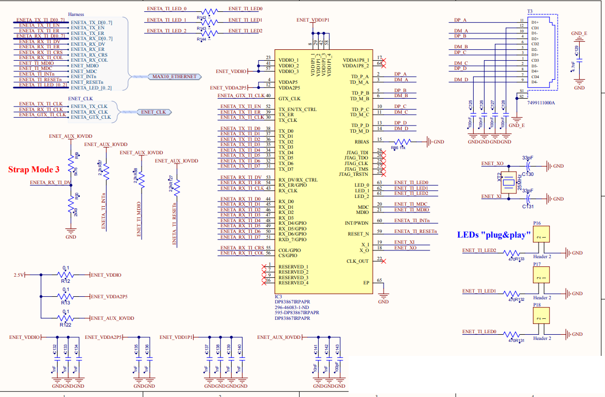

I have output signals, so the chip is doing something, anyway, I'll first want to fix the MDIO problem. This is the schematic:

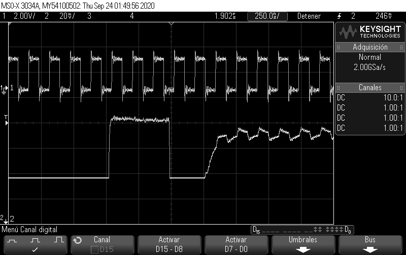

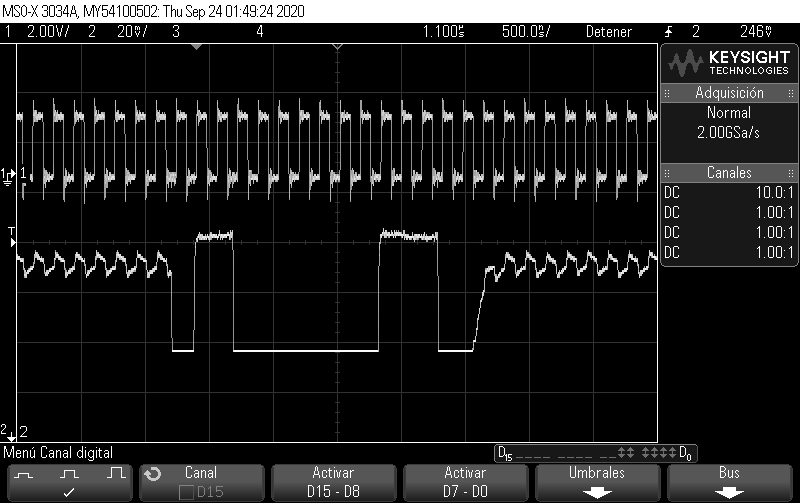

And that's what I'm seeing when looking at the MDIO:

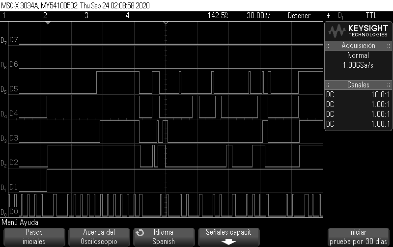

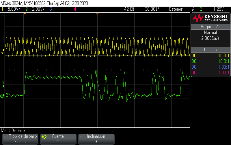

I'll also add some images of the TX RGMII not working properly.
D0: Tx CLK, D1: Enable,  From there Data from 0 to 3.
Any ideas? To communicate we are using an FPGA, it has worked with other chips.

    Do you have a pull up resistor to VDDIO on the MDIO pin as per our recommendation in our datasheet? I do not see it on your schematic.
    Is there anything else connected to the MDIO pin? Would you be able to use an mcu to use as external MDC and MDIO?
    Cecilia
  • Hello Cecilia,
    The pull up you're mentioning is R88, you can see it next to the "Strap Mode 3" text, it's the 3rd circuit on that row. For what I recall the pull up was only for MDIO not MDC, right?
    The MDIO is connected to the FPGA pin and it goes throgh one 0 ohm resistor and a test via, that's it.

    In the first two screenshots, is signal 1, MDC and signal 2 MDIO? Also just wanting to confirm that I'm reading this correctly that MDIO is at 20mV/div? What voltage is the FPGA using for its MDC and MDIO signal?
    Also in the last image what is signal 1 yellow and signal 2 green? The quality of the clock and data does not look very clean. So i want to confirm the signal integrity of your crystal and RX_CLK.
