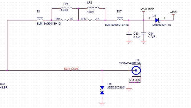

Hi team,
customer requirement is 10V/500mA, below is current circuit, could you help to review and give suggestions about how to select inductors? thanks

Hi Betty,
In order to design a proper PoC network, the customer will need to consider the frequency range, the current rating, and temperature. Usually with ferrite beads, the current rating of the network won't support such high frequency. Could you shoot me an email so I can share with you some of the other networks we have?
