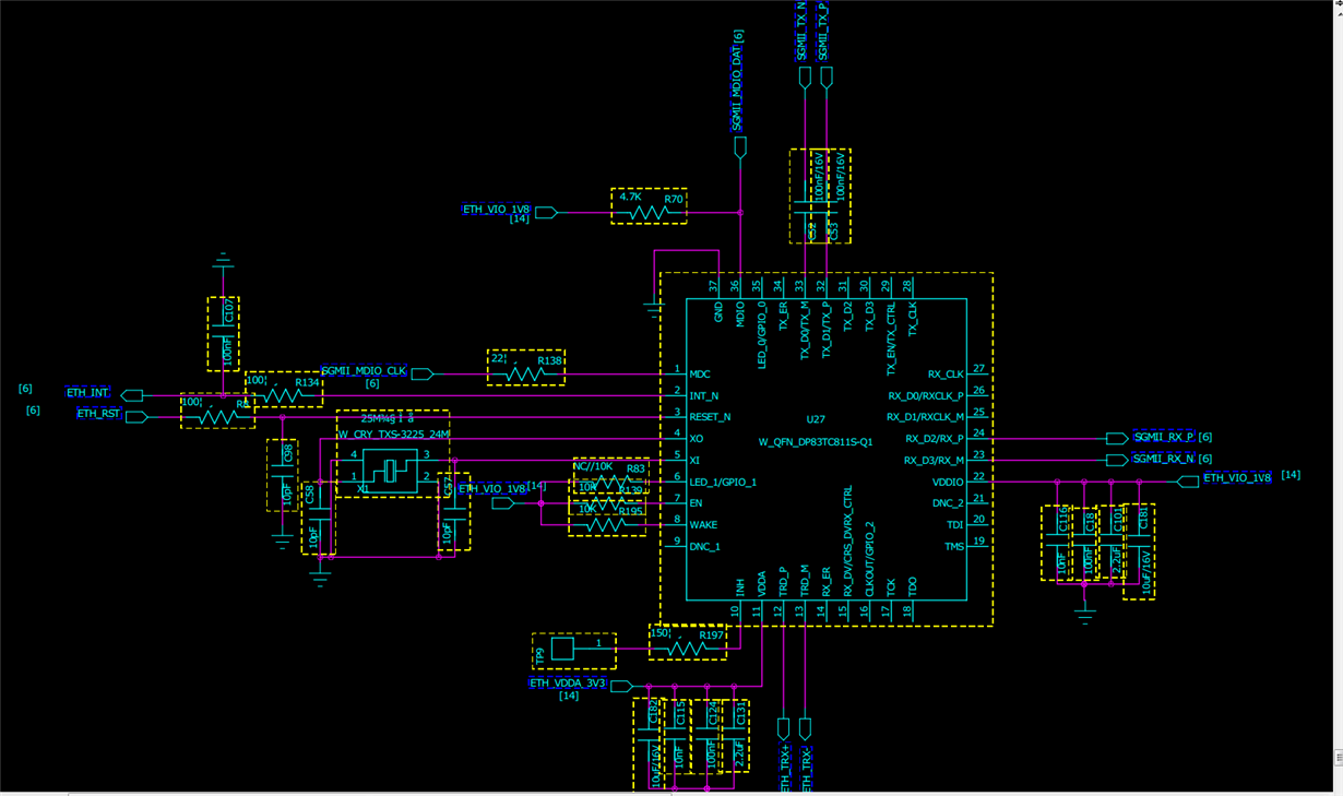

DP83TC811S-Q1: The driver code matches the kernel version
Part Number: DP83TC811S-Q1
Other Parts Discussed in Thread: DP83TC811

when i add  code to support  C45 as fllow:
ethphy0: ethernet-phy@1 {
compatible = "ethernet-phy-ieee802.3-c45";
reg = <0>;
It cannot  read phyID,phy_id is 0
3.446179] libphy: emac-mdio: probed
[ 3.452680] get_phy_device:===>r(0)phy_id(0) is_c45=1
I think it is a problem with the phy_read_mmd function, which is inconsistent with the current kernel version.
Can you provide a driver based on the current kernel version

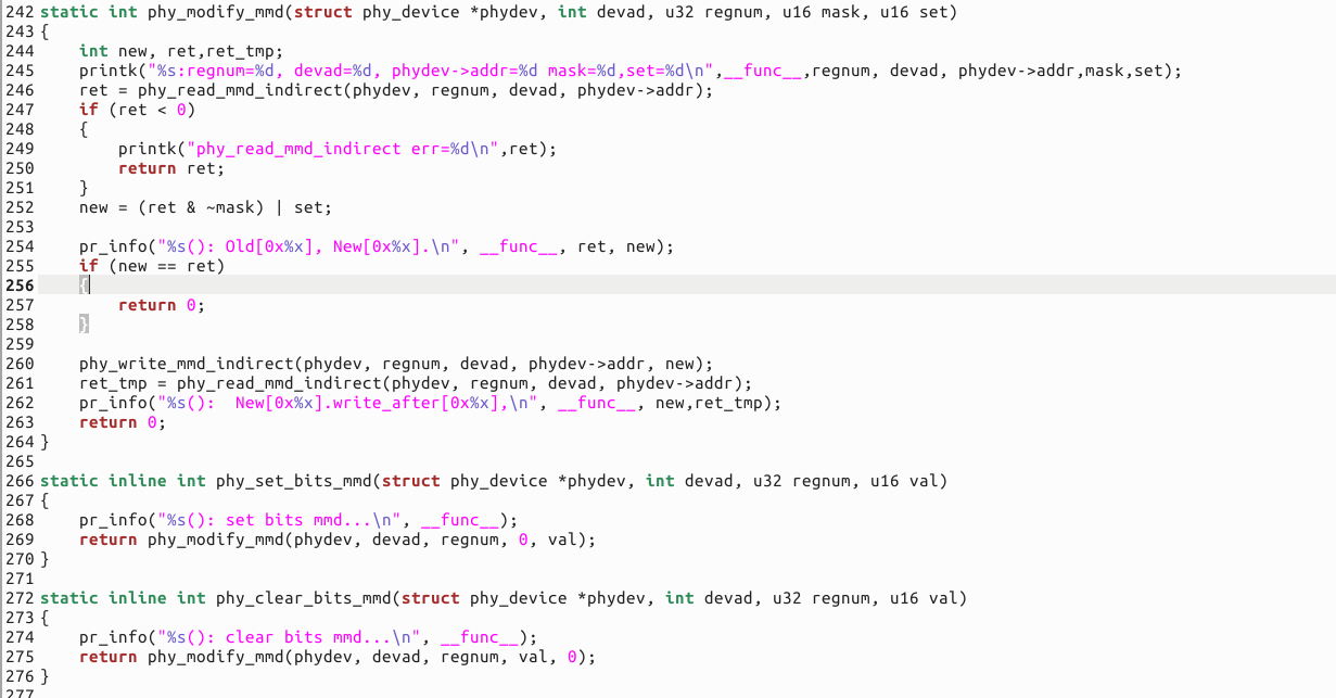

  • dear  Nikhil
    Or how to implement the read and write operations of dp83811 based on the current kernel version interface
    Give the latest dp83811 driver,
    We tried to modify as follows, but found that the write function to write and it  was not successful
    change phy_write_mmd to phy_write_mmd_indirect
    and change phy_read_mmd to phy_read_mmd_indirect.
    thanks
  • dear  nikhil:
    init  log:
    [ 2.431054] dp83811_init

    [ 1278.713656] phy_set_bits_mmd(): set bits mmd...
    [ 1278.718233] phy_modify_mmd:regnum=1184, devad=31, phydev->addr=0 mask=0,set=2048

    [ 1278.810529] phy_modify_mmd(): Old[0x1000], New[0x1800].

    [ 1278.983442] phy_modify_mmd():  New[0x1800].write_after[0x1000],

    Based on the register values, it looks like there is no link, and the device is set for 100M speed in SGMII mode. Is this the desired mode of operation?
    Could you also provide me a schematic?
    Thank you,
    Nikhil
  • dear  Nikhil
    sorry for late repaly because we have a holiday.
     our device is sure working  in 100M speed and in SGMII mode,this is correct and the desired mode of operation.
    Why the device has no link, which register configuration problem or process problem?
    We need to provide a schematic diagram about  what?
    I don‘t  understand.

  • dear Nikhil
    we  found  the write function write not suscess.
    as fllow:
    [ 650.855595] phy_set_bits_mmd(): set bits mmd...
    [ 650.860051] phy_modify_mmd:regnum=0x4a0, devad=0x1f, phydev->addr=0x0 mask=0,set=0x800
    [ 650.868016] emac_mdio_write writing phy addr 0 phy regnum 0x0d val=0x001f
    [ 650.874801] emac_mdio_write:11 writing phy addr 0 phy regnum 0x0d val=0x001f
    [ 650.881906] emac_mdio_write:EMAC PHY ADDR 0 PHY WR 0x0d -> 0x0000
    [ 650.887902] emac_mdio_write writing phy addr 0 phy regnum 0x0e val=0x04a0
    [ 650.894788] emac_mdio_write:11 writing phy addr 0 phy regnum 0x0e val=0x04a0
    [ 650.901786] emac_mdio_write:EMAC PHY ADDR 0 PHY WR 0x0e -> 0x0000
    [ 650.907778] emac_mdio_write writing phy addr 0 phy regnum 0x0d val=0x401f
    [ 650.914524] emac_mdio_write:11 writing phy addr 0 phy regnum 0x0d val=0x401f
    [ 650.921663] emac_mdio_write:EMAC PHY ADDR 0 PHY WR 0x0d -> 0x0000
    [ 650.927686] phy_read_mmd_indirect:prtad=0x4a0, devad=0x1f, addr=0x0 func=[emac_mdio_read+0x0/0x230]// read function
    [ 650.936664] emac_mdio_read:addr=0x0,regnum=0xe
    [ 650.941038] emac_mdio_read reading phy addr 0 phy regnum 0x0e
    [ 650.947087] emac_mdio_read:11 reading phy addr 0 phy regnum 0x0e
    [ 650.953126] emac_mdio_read:EMAC PHY ADDR 0 PHY RD 0x0e -> 0x1000// the 0x4a0 reg value is 0x1000 write before
    [ 650.958978] phy_modify_mmd(): Old[0x1000], New[0x1800].
    [ 650.964197] emac_mdio_write writing phy addr 0 phy regnum 0x0d val=0x001f
    [ 650.970911] emac_mdio_write:11 writing phy addr 0 phy regnum 0x0d val=0x001f
    [ 650.978134] emac_mdio_write:EMAC PHY ADDR 0 PHY WR 0x0d -> 0x0000
    [ 650.984096] emac_mdio_write writing phy addr 0 phy regnum 0x0e val=0x04a0
    [ 650.990953] emac_mdio_write:11 writing phy addr 0 phy regnum 0x0e val=0x04a0
    [ 650.998049] emac_mdio_write:EMAC PHY ADDR 0 PHY WR 0x0e -> 0x0000
    [ 651.003933] emac_mdio_write writing phy addr 0 phy regnum 0x0d val=0x401f
    [ 651.010732] emac_mdio_write:11 writing phy addr 0 phy regnum 0x0d val=0x401f
    [ 651.017905] emac_mdio_write:EMAC PHY ADDR 0 PHY WR 0x0d -> 0x0000
    [ 651.023804] phy_write_mmd_indirect:prtad=0x4a0, devad=0x1f, addr=0x0 func=[emac_mdio_write+0x0/0x230]
    [ 651.033037] emac_mdio_write writing phy addr 0 phy regnum 0x0e val=0x1800
    [ 651.039793] emac_mdio_write:11 writing phy addr 0 phy regnum 0x0e val=0x1800
    [ 651.047005] emac_mdio_write:EMAC PHY ADDR 0 PHY WR 0x0e -> 0x0000
    [ 651.052880] emac_mdio_write writing phy addr 0 phy regnum 0x0d val=0x001f
    [ 651.059663] emac_mdio_write:11 writing phy addr 0 phy regnum 0x0d val=0x001f
    [ 651.066867] emac_mdio_write:EMAC PHY ADDR 0 PHY WR 0x0d -> 0x0000
    [ 651.072753] emac_mdio_write writing phy addr 0 phy regnum 0x0e val=0x04a0
    [ 651.079686] emac_mdio_write:11 writing phy addr 0 phy regnum 0x0e val=0x04a0
    [ 651.086712] emac_mdio_write:EMAC PHY ADDR 0 PHY WR 0x0e -> 0x0000
    [ 651.092606] emac_mdio_write writing phy addr 0 phy regnum 0x0d val=0x401f
    [ 651.099450] emac_mdio_write:11 writing phy addr 0 phy regnum 0x0d val=0x401f
    [ 651.106629] emac_mdio_write:EMAC PHY ADDR 0 PHY WR 0x0d -> 0x0000  // write 0x1800 to reg 0x4a0  return 0 sucess
    [ 651.112487] phy_read_mmd_indirect:prtad=0x4a0, devad=0x1f, addr=0x0 func=[emac_mdio_read+0x0/0x230]
    [ 651.121571] emac_mdio_read:addr=0x0,regnum=0xe
    [ 651.126002] emac_mdio_read reading phy addr 0 phy regnum 0x0e
    [ 651.131870] emac_mdio_read:11 reading phy addr 0 phy regnum 0x0e
    [ 651.138031] emac_mdio_read:EMAC PHY ADDR 0 PHY RD 0x0e -> 0x1000//read reg 0x4a0  again ,found the value is  0x1000
    Are you able to share a schematic for a review?
    Thank you,
    Nikhil

  • dear Nikhil
    I  think  our read/write  steps  is right.
    [ 650.868016] emac_mdio_write writing phy addr 0 phy regnum 0x0d val=0x001f----------//0x0d  write 0x001f
    [ 650.881906] emac_mdio_write:EMAC PHY ADDR 0 PHY WR 0x0d -> 0x0000---------//write 0xd   return 0,ithis return value print ,without effect
    [ 650.887902] emac_mdio_write writing phy addr 0 phy regnum 0x0e val=0x04a0--------///0x0e  write 0x04a0
    [ 650.901786] emac_mdio_write:EMAC PHY ADDR 0 PHY WR 0x0e -> 0x0000-----------//write 0x0e  return 0,ithis return value print ,without effect
    [ 650.907778] emac_mdio_write writing phy addr 0 phy regnum 0x0d val=0x401f---------------//0x0d  write 0x401f
    [ 650.921663] emac_mdio_write:EMAC PHY ADDR 0 PHY WR 0x0d -> 0x0000-------------//write 0xd   return 0,ithis return value print ,without effect
    [ 650.941038] emac_mdio_read reading phy addr 0 phy regnum 0x0e-------//read 0x0e  register  return value is 0x1000
    write:
    [ 650.958978] phy_modify_mmd(): Old[0x1000], New[0x1800].---------//we need  0x1800 to  reg 0x4a0
    [ 650.964197] emac_mdio_write writing phy addr 0 phy regnum 0x0d val=0x001f----------//0x0d  write 0x001f
    [ 650.978134] emac_mdio_write:EMAC PHY ADDR 0 PHY WR 0x0d -> 0x0000-------------//-//write 0xd   return 0,ithis return value print ,without effect
    [ 650.984096] emac_mdio_write writing phy addr 0 phy regnum 0x0e val=0x04a0---------///0x0e  write 0x04a0
    [ 651.003933] emac_mdio_write writing phy addr 0 phy regnum 0x0d val=0x401f---------//0x0d  write 0x401f
    [ 651.033037] emac_mdio_write writing phy addr 0 phy regnum 0x0e val=0x1800--------//write 0x1800  to  0x0e
    ---------------read back 0x4a0
    [ 651.138031] emac_mdio_read:EMAC PHY ADDR 0 PHY RD 0x0e -> 0x1000//read reg 0x4a0  back ,found the value is  0x1000

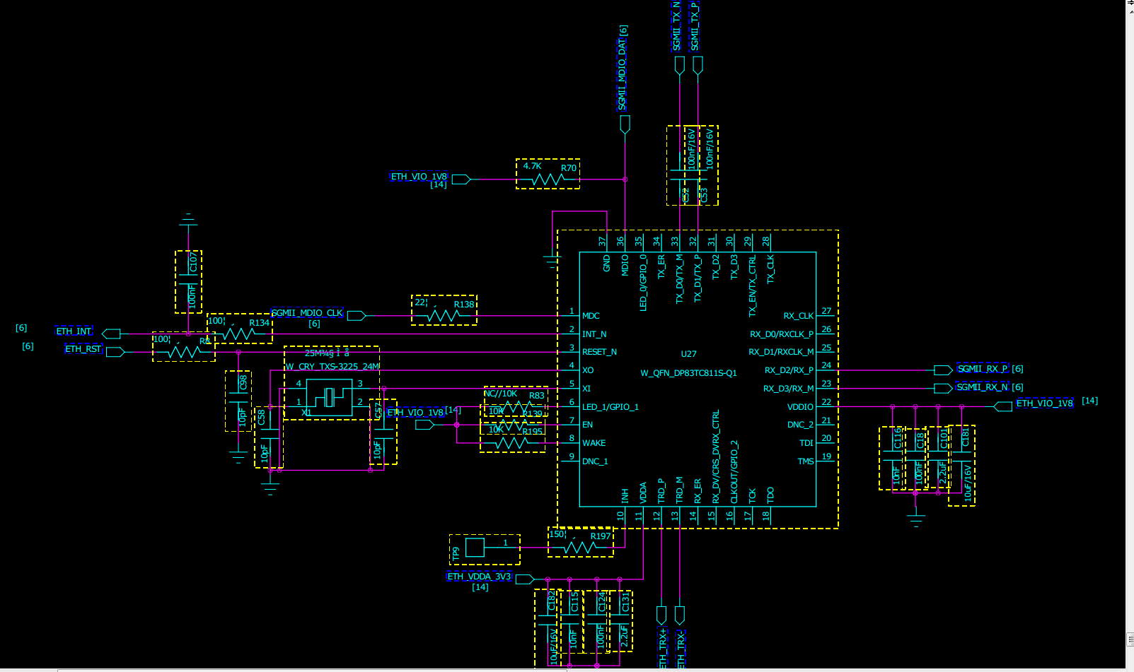

    weather  schematic  is  correct  or not after you check?
    The schematic looks ok. Could you clarify  the distinction between the lines [ 651.003933] and [ 651.010732] in the above reply? It looks like the same write function is duplicated? Line [ 650.978134] suggests that register 0xD is being written to 0x0? It looks like register 0xE is also being written to 0x0.
    If this is the case please remove the duplicate statements and do not set registers 0xD and 0xE to 0x0 between read and write statements. Please follow the 4-step process described in the datasheet.
    Please let me know if this does not solve the issue.

  • dear  Nikhil
    between the lines [ 651.003933] and [ 651.010732] is  the same function print,U need to  ignore the line [ 651.010732] print.
    Line [ 650.978134],WR 0x0d -> 0x0000       this is not write 0x0000 to 0xd ,this is write operation return print, U need to  ignore it。
    thank you
  • dear  Nikhil
    I have modified the log print,as fllow:

    [ 49.225916] emac_mdio_write:end retval=0
    [ 49.229945] emac_mdio_write:EMAC PHY ADDR 0 PHY WR 0x0d -> 0x401f,ret=0
    [ 49.236448] emac_mdio_write:end retval=0
    [ 49.240599] emac_mdio_read:EMAC PHY ADDR 0 PHY RD 0x0e -> 0x1000
    [ 49.246312] emac_mdio_read:end retval=4096
    [ 49.250357] phy_read_mmd_indirect:prtad=0x4a0, devad=0x1f, addr=0x0 value=0x1000 func=[emac_mdio_read+0x0/0x22c]
    [ 49.260729] dp83811_suspend value=4096
    [ 49.264608] emac_mdio_read:EMAC PHY ADDR 0 PHY RD 0x00 -> 0x2100
    [ 49.270293] emac_mdio_read:end retval=8448
    [ 49.274698] emac_mdio_write:EMAC PHY ADDR 0 PHY WR 0x00 -> 0x2900,ret=0
    [ 49.280909] emac_mdio_write:end retval=0
    [ 49.284894] msm_emac_request_pinctrl_off:
    It looks like Bit[11] of register 0x04A0 is a self-clearing bit. This means, that though you may write to it, it will self clear back to 0, which is why you see the subsequent read is back to 0x1000. To test the functionality of the WoL in this manner, you may enable WoL, set the output to level mode (this will create an interrupt that is constantly pulled high rather than a single pulse), then create a WoL event. Observe that the signal is high, write 0x04A0 = 0x1800 and observe the signal clear and the bit clear. Please let me know if this solves the issue.
