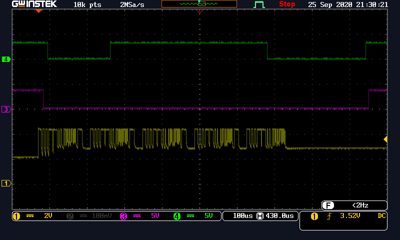

    I believe I may have used the wrong terminology when I say "wake" from Standby to Normal, it probably rather should have been "service". However, I can say that the WUP absolutely does have an effect on the TCAN4550 in Standby mode. The nWKRQ interruption (talking about the interrupt, not the pin!) is routed through the nINT interrupt line: when a new CAN frame with the pattern was incoming, I could observe that this interruption triggered properly, and I could use it to make the microcontroller service the transceiver by transitioning it from Standby to Normal through a SPI write. Note once more that this is after startup, configuration in Standby mode, and nominal use of the Normal mode for a few CAN transactions; I had put the device from Normal to Standby to test how it can be used in my application. I would also like to note that the nWKRQ pin (this time I really mean the pin, not the interrupt) also reflects what I have mentioned. Please refer to the oscilloscope screenshot I have attached below:
    The CANH line is in yellow, and the nWKRQ pin of the TCAN4550 is in purple. The green signal is a GPIO signal coming from my microcontroller used for debugging purposes and may be ignored. This figure shows what happens when another actor on the CAN bus starts broadcasting a frame with automatic re-transmission on failed transmissions. You will see that the nWKRQ pin is pulled low during the broadcast of the first frame. After transitioning the TCAN4550 from Standby to Normal through an SPI write, the transceiver is finally in Normal mode and capable of acknowledging the fifth frame (i.e. fourth re-transmission). Once this is done, the interrupt register is written back to in order to clear the interrupts, and you may see that the nWKRQ is released back to high after a time.

    If the device has entered Sleep Mode, the Sleep Mode Status (SMS) bit of the Interrupts register (0x0820[23]) has been set. This can be used as an indication that the device was in in Sleep Mode during the Wake Event.
    I have just verified this and this is not entirely correct. The SMS bit of the interrupts register will only be set to 1 if the device has transitioned to Sleep due to a WKERR, UVIO timeout, or UVIO+TSD fault (as per the datasheet). However the SMS flag will be set to zero if the host microcontroller has willingly transitioned the TCAN4550 into Sleep mode from Normal/Standby. This is useful to know if the device needs to be reconfigured if an error has occurred (for instance, if the microcontroller has failed to configure and transition it to Normal mode within 4 minutes of Power On, or after a Wake from Sleep if the SWE_DIS bit in register 0x800 is set to 0). In this case, I would still need to keep track of the TCAN4550's mode on the microcontroller side to differentiate when the device was set to Sleep by the microcontroller and when the transceiver was in Standby.

    Thank you for the clarifications and observations. I will admit I was a little bit confused by a couple of things in your original post, but I now have a clear understanding of what you are asking and trying to accomplish. I will also admit that I completely misspoke on the Wake Up behavior in Standby Mode. You are correct and I am at a loss of words why I would state that Wake Up functionality is not available in Standby Mode other than I think I was thinking in terms of waking up from a true Sleep Mode and I just had a mental lapse on the Standby Mode. I apologize for the confusion, but I have edited my original post to correct and clarify the information in the post.
    I addressed your latest question in the edits, but no, the device does not always need to be re-configured when in Standby Mode before transitioning into Normal Mode. If the device was placed into Standby Mode by the MCU through the MODE_SEL bit field, then it will retain all the configuration settings and will only need to be placed back into Normal Mode through the MODE_SEL bit field after a Wake Up event is detected.
    Unfortunately the SPI bus is both a feature and a limitation depending on your perspective. It allows the device to be used in any number of systems with any MCU that has a SPI bus. In that regard it is an enhanced feature. However, it is a limiting factor on the total throughput and response time for CAN related activity such as Wake Up Events due to the extra time required to pass the information between the device and the MCU through the SPI bus. My only recommendations on reducing this is to use the fastest SPI rate possible, and to make the MCU firmware structure as optimized as possible so that it can detect and respond to an interrupt from the device as quickly as possible. Outside of that, there is not much that can be done.
