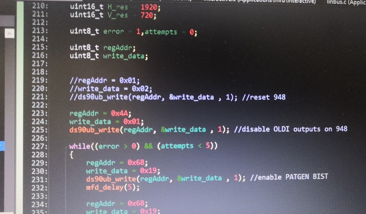

My customer is using UB948 for display and found the video display shaking issue.
They want to check the HS, VS value on UB948 to double check the data they were to send out from SoC.

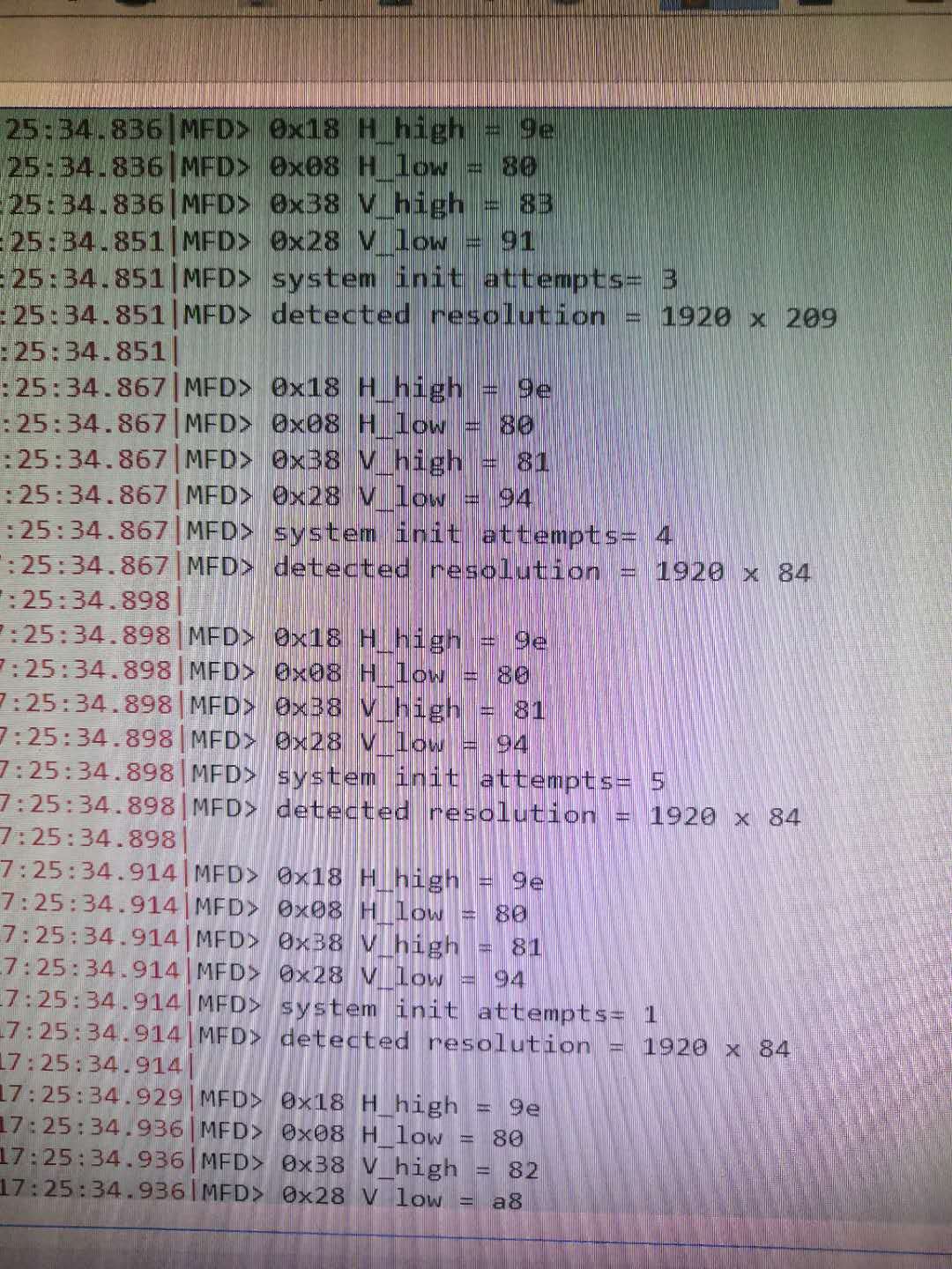

Right now they're running the setting as below picture, but found the read data is changing every second and is far away from the original display setting. They have 1920*720*60, but the read out data is not correct.
Could you please help to check and see if you have any ideas for this case?
