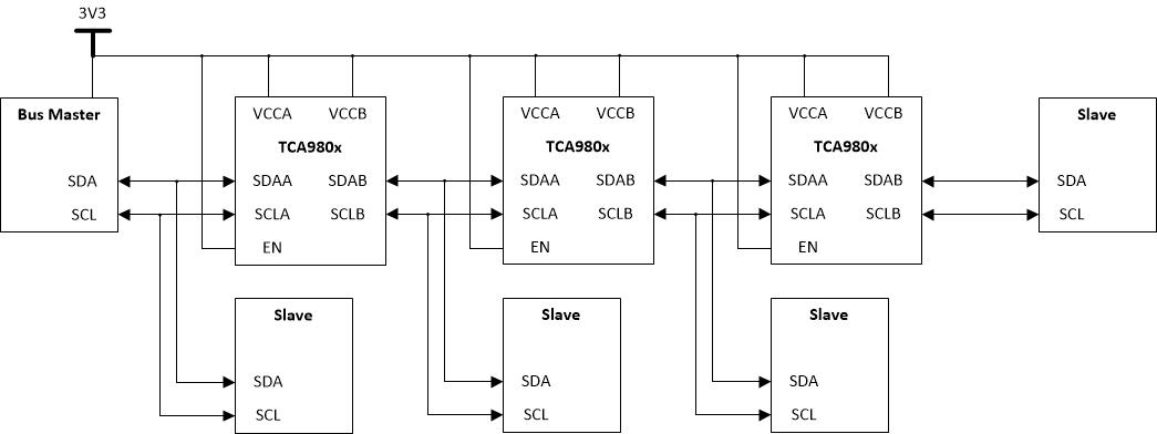

Hi Everyone,
I would like to know if I can use the TCA980x in the configuration shown below as a type of bus repeater. It features:
Damien
This will work. But every repeater adds its propagation delay, so it might be necessary to reduce the frequency. (Check the timing at the last slave.)
Why so many repeaters? Are the bus segments actually larger than shown above? Would it be possible to use a star topology?
Excellent thanks for the quick feedback. Noted about the frequency.
The bus segments will be long and all in a line, hence the topology. A star topology will not work for this application.
