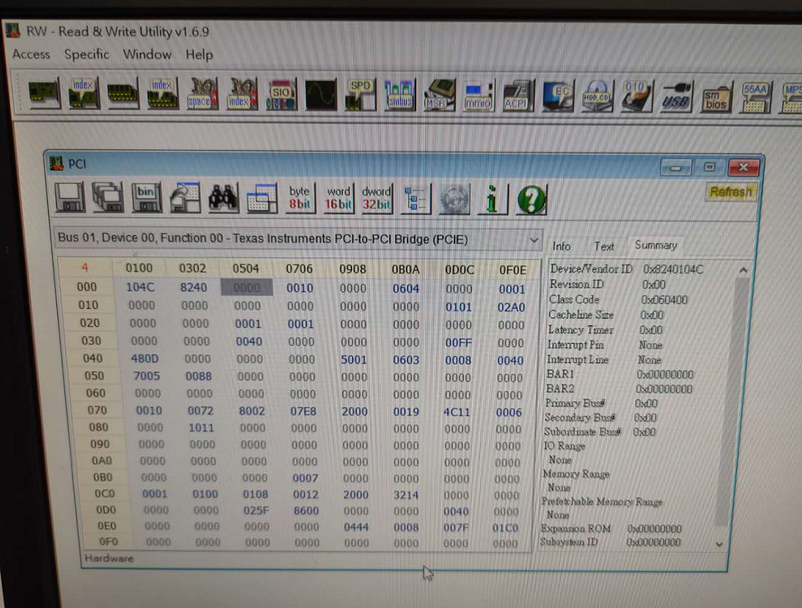

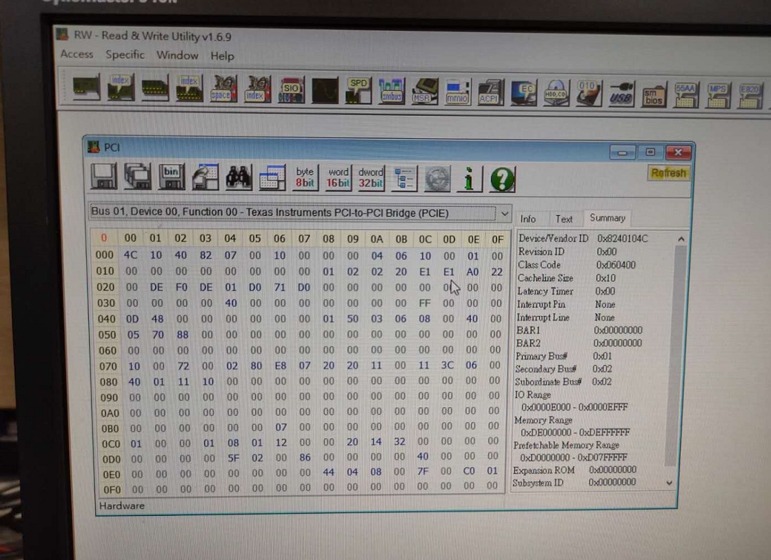

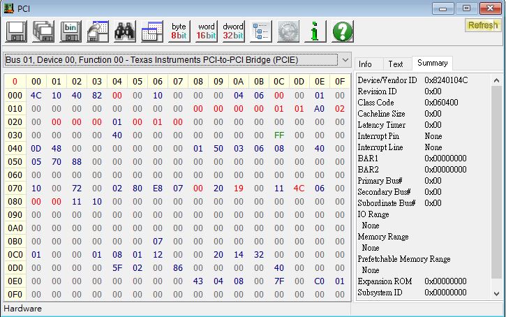

     They tried to dump the register of XIO2001 before and after abort below.
      @ Default normal register
 @ Abort and read the register again
 Some registers are modified. For ex, the value of address 0x4 is modified from 0x07 to 0x00.
