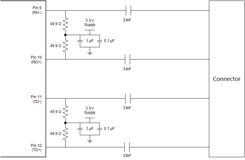

Hello team,
Is the following configuration possible when using DP83822I?
"PHY → Capacitor → Connector → Harness → Connector → Capacitor → PHY"
This configuration is used at board connection in the product the customer is developing.
