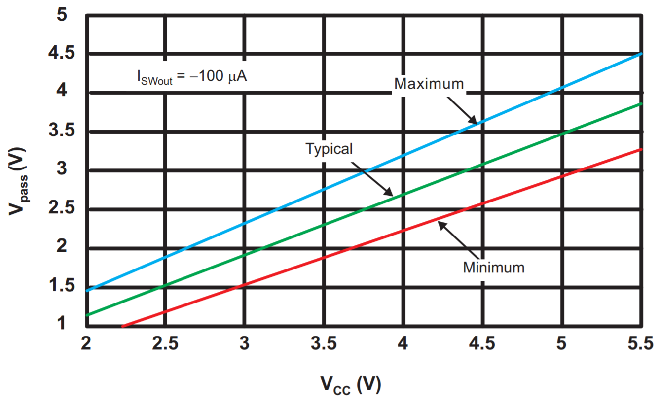

    Your selection for VCC of the device (pin 24) is driven by the lowest operating voltage out of all of the connected buses. This is because Vpass must be equal to or below the lowest overall bus voltage. You can use this graph (section 9.2.3 of the PCA9548A datasheet) to determine maximum VCC using Vpass(max):

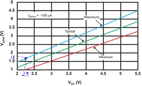

    Note that the minimum supply voltage (VCC) for this device is 2.3 V, which can be found under Recommended Operating Conditions. Using the graph above, it can be seen that this minimum supply voltage does not allow a Vpass of 1.2 V. For design purposes, the “maximum” curve should be used, as it is considered the worst-case. This is why, as you noted in your question, the datasheet lists 1.8 V for any secondary but not 1.2 V. See the markup below, showing this:
