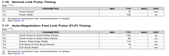

Hi Experts,
Are there any deviation data or min/max data for normal link pulse and fast link pulse which are defined as typical as shown in below.
Can you estimate, for example, about ±20%?

Hi Hisao,
We do not characterize tolerance of FLP timing and cannot guarantee this number.
