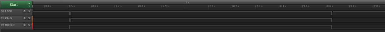

On the image below is what I captured.
Yellow signal is BISTEN pin and the purple one is signal on pin 7 on Deserializer.
I expect PASS signal on purple signal, but it's going LOW right after BISTEN is set to LOW and that is not what I expected.
Questions: Is the whole procedure right and how can I be sure that I read PASS signal?
If purple signal is PASS signal, why it's going LOW although there is no any LOW level in half-pixel clock period that means there is no error in BIST?

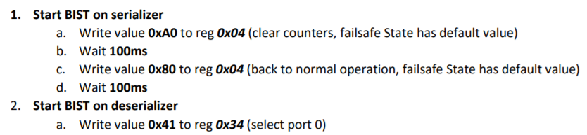

    I'm sending this summary again because this topic has so many posts.
    5148.BIST_issue.pdf
    Do you have any idea how to continue debugging this issue?
    Thank you very much for support!
    Tomislav

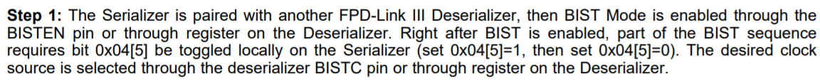

  • Tomislav,
    Backing up here - what is the reason that you can not simply enable BIST through registers via the 949 side using register 0x14? There is no need to implement this overly complicated method which seems to have some issues anyways.
    Casey
  • Sorry disregard my previous comment - I see that the issue with that was the deserializer needs to be the side to initiate the BIST or it will not properly go into BIST RX mode while the 949 is in BIST TX mode.
    I found how to resolve your issue but I'm not sure why it is happening. We will need to check that offline and see what the cause is. It looks like sometimes (it doesn't happen every time) when BIST is disabled via pin, the BC watchdog timer is getting turned off at the serializer side. Notice the default for 949 register 0x16 is 0xFE and when the comms stop working it gets reset to 0x01. It seems like during the BIST enable/disable process there is a BC CRC error and because the watchdog it turned off, it will lock up the channel. You can clear the issue by setting 0x16 = 0xFE, or by issuing a digital reset at the serializer with 0x01 = 0x02
    Casey

  • Hello Tomislav,
    Your sequence for clearing CRC errors is not matching the datasheet:
    You need to clear CRC error count after BIST is enabled (in the beginning of the test). Your sequence is toggling the CRC error count clear before enabling the test.
    Casey

    Thank you very much for your patience here. After some discussion on this internally, I believe the errors you are seeing are most likely a result of the sequence which is happening going into and out of BIST, not necessarily capturing real errors during the test. The reason is that going into or out of BIST triggers a loss of LOCK which subsequently may cause a few transient errors as the DES unlocks. You can see the effect here on a setup which I have for example:
    So when the test concludes, you are essentially seeing errors which are related to the normal relocking process and not actual errors from the test. The most accurate way to actually check errors during the test is to monitor the PASS pin while BISTEN is high to see if there are any drops. I'm looking internally to see if there is any other possible method, but it appears that this may be the only solution. Of course, the documentation should likely get updated to clarify this as well in the datasheet
    Casey

  • Hello Tomislav,
    Here is a validated script we have used before to perform the BIST test using only reg writes but it requires connection of I2C directly to the 948 side. We don't have any known way to implement the test using remote connection like you have implemented here due to the issues discussed previously.
    949-948_Link_190MHz_FLAT.zip
    Casey
