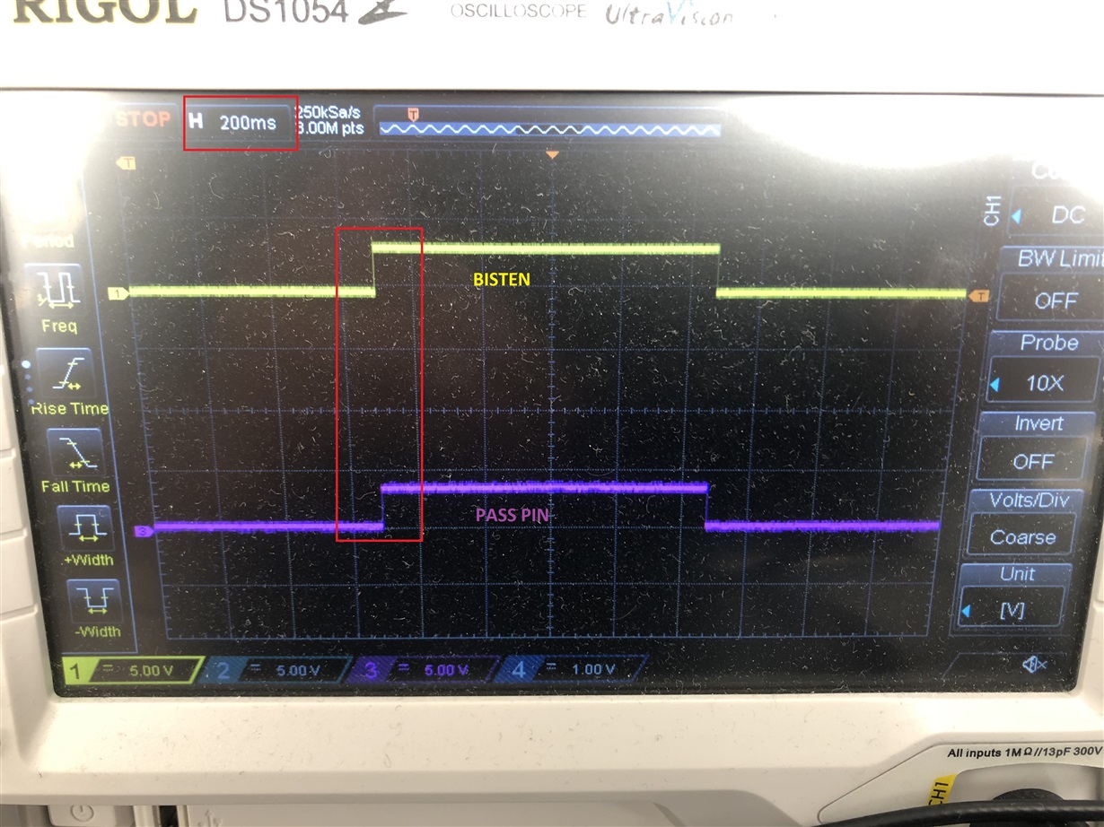

We are using the DS90UB949-Q1 and DS90UB948-Q1 ser/des pair to drive some displays in our IVI device. We are using BIST function on the DS90UB948-Q1 deserializer to check the FPD-Link quality and status during the device operation.
Result of BIST is on PASS pin so I want to read BIST PASS signal on deserializer pin 7 with oscilloscope.
PASS pin is shared with GPIO0 and SDOUT so I'm not completely sure that I read exactly PASS signal, and not GPIO0 value or SDOUT value.
What I did?
  1. First I set BIST_CONTROL(0x24) register on deserializer with value :
BIST_EN : 0
BIST_CLOCK_SOURCE : 01
BIST_PIN_CONFIG : 1 (I want to start BIST with BISTEN pin )
AUTO_OSC_FREQ : 1
BIST_OUT_MODE : 01
2. Then switch to port 0 and set GPIO0_CONFIG register to value:
GPIO0_DIR _D_GPIO0_DIR : 00 (Functional mode) - I expect to get PASS signal on pin 7
Rest of values in register are 0.
3. Then set D_GPIO0 (pin 19) to HIGH and D_GPIO[3:1] (pins 16, 17,
and 18) to LOW.
4. Set BISTEN pin to HIGH
5. Toggle 0x04[5] on the serializer. (MCU is on serializer side)
6. After 1 sec BISTEN pin is set to LOW

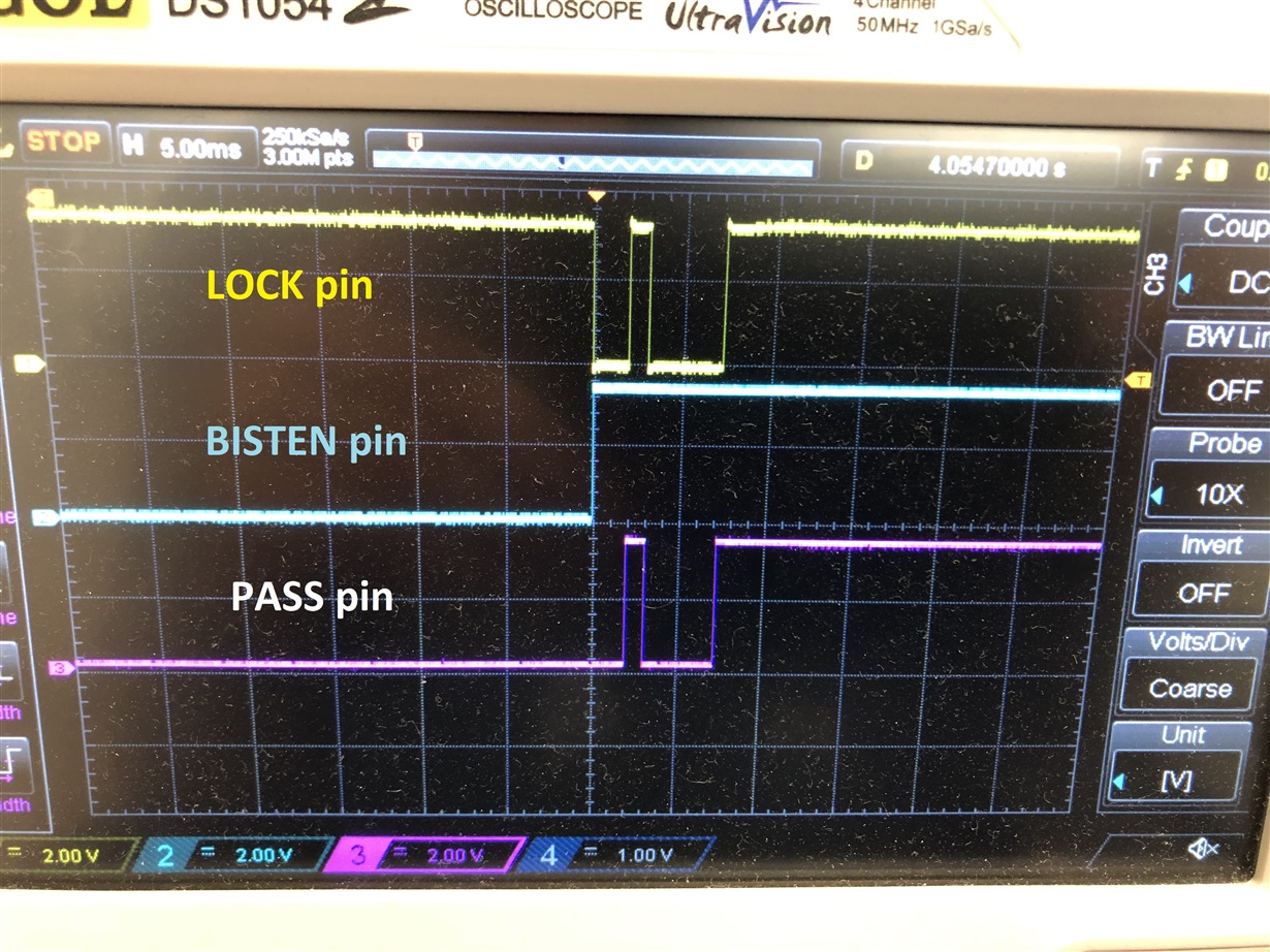

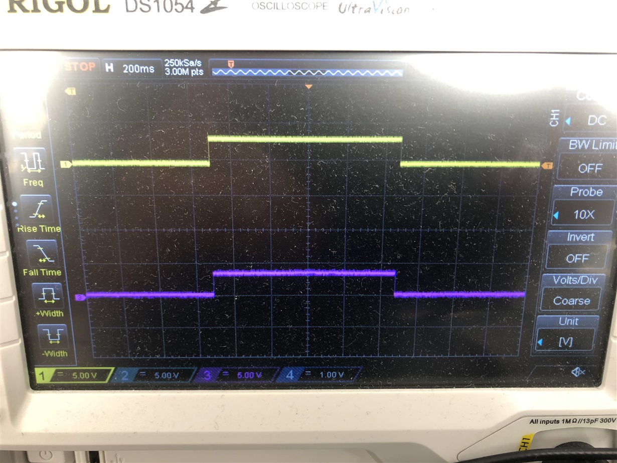

On the image below is what I captured.
Yellow signal is BISTEN pin and the purple one is signal on pin 7 on Deserializer.
I expect PASS signal on purple signal, but it's going LOW right after BISTEN is set to LOW and that is not what I expected.
Questions: Is the whole procedure right and how can I be sure that I read PASS signal?
If purple signal is PASS signal, why it's going LOW although there is no any LOW level in half-pixel clock period that means there is no error in BIST?
Also, after BISTEN is set to low, I’m trying to read some registers on Serializer and Deserializer via I2C. I managed to read serializer registers after that, but Deserializer and everything on I2C bus on DESER side Is not available. I don’t get ACK on I2C communication.
Thank you!
Tomislav

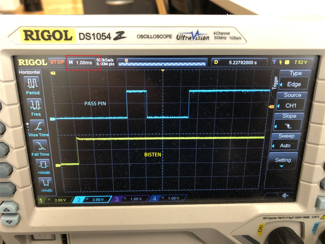

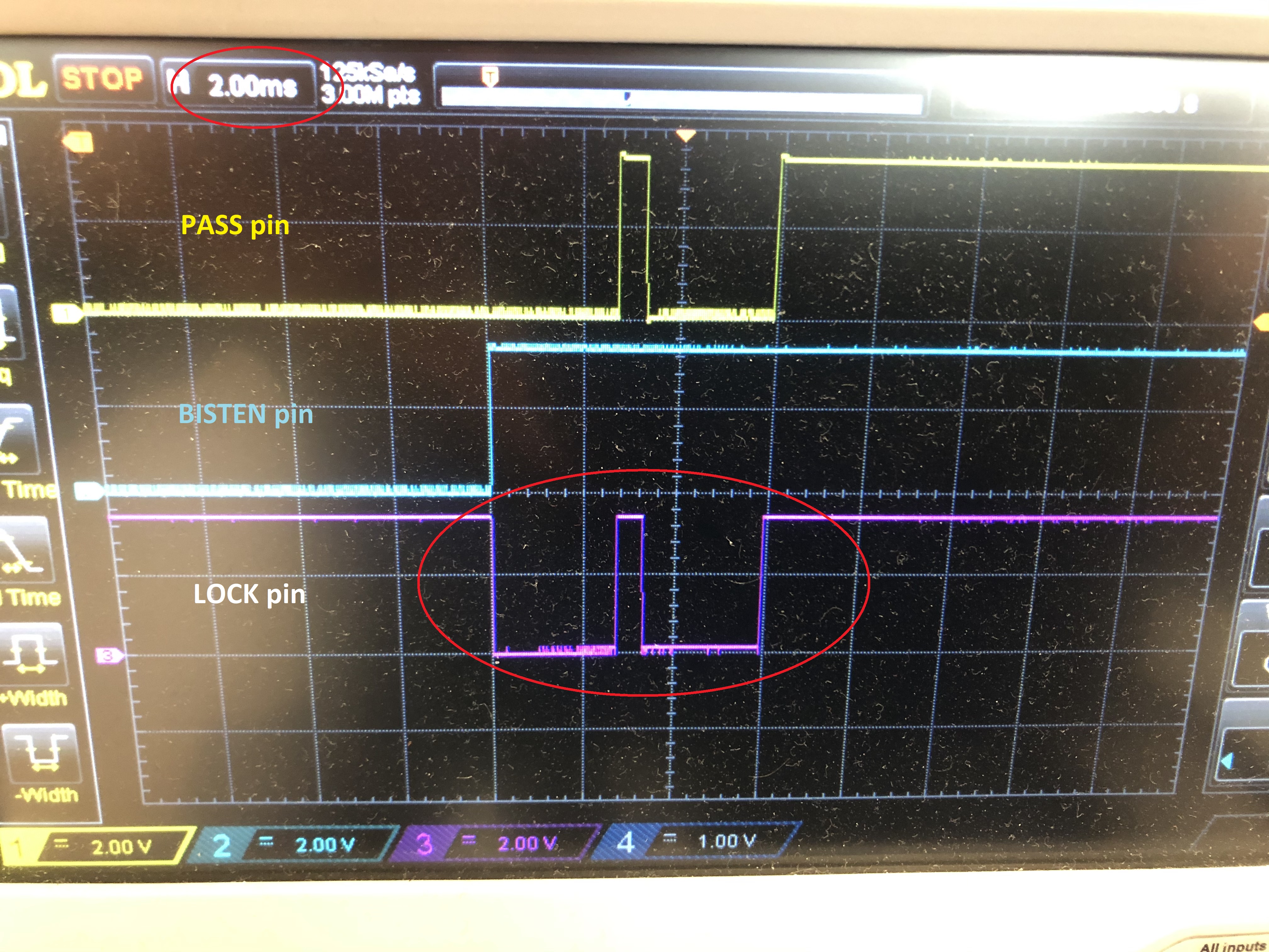

    UPDATE:
    I captured BISTEN pin and PASS pin again and I found out that there is a drop (aprox. 2,5ms in LOW) in pass pin on the beginning of test. That's why PASS pin is LOW at the end of BIST. I guess...
    You can see the signals on the images below. The second image represent red rectangle on the first image.
    Do you have any guesses as to why this is happening?
    Thanks!

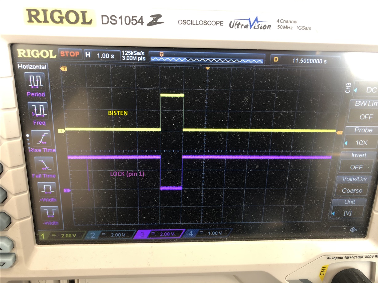

  • One more information...
    Below it's a capture of BISTEN pin and LOCK pin.
    I don't know if that means anything to you.
    Tomislav

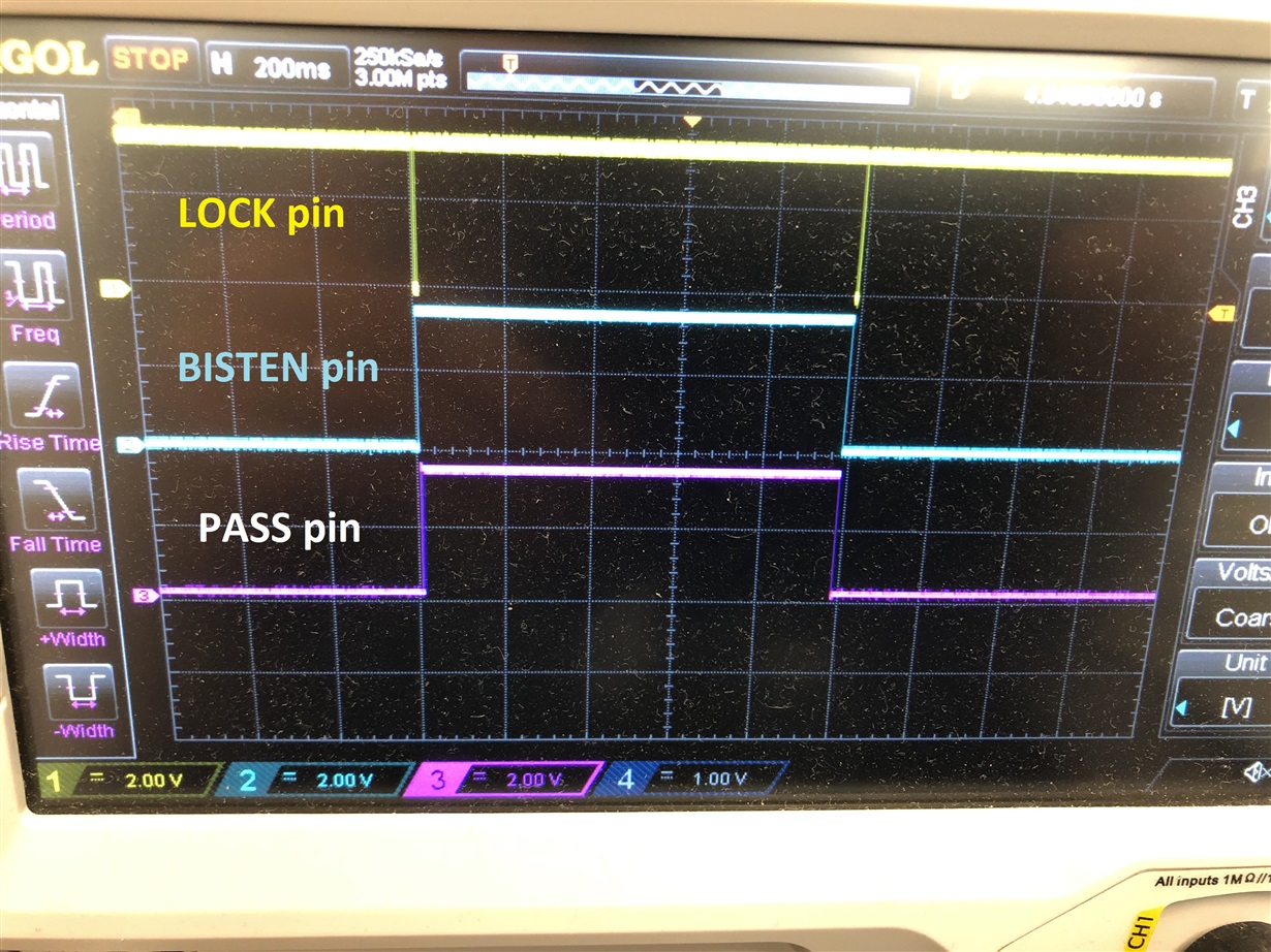

  • Hi Michael,

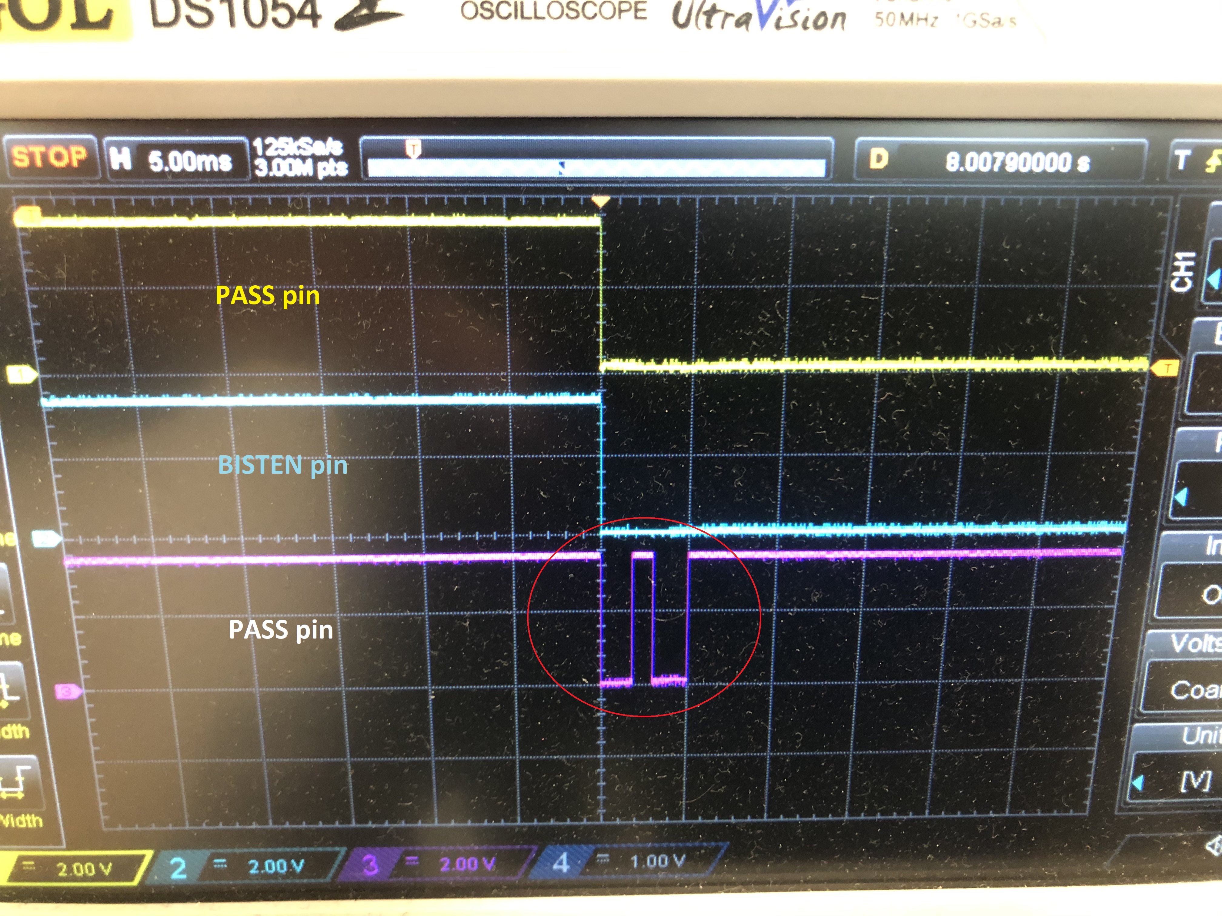

    First, I repeated starting BIST before video is going into 949, but I change timing a little bit.
    Now I managed to communicate with 948 after BIST is stopped but I caught a BIST errors in 948 and 949 registers:
    • deserializer, reg 0x25 = 5u (sometimes 6u)
    • serializer, reg  0x1B = 3u (sometimes 4u)
    Here are the captured signal. On the second image is detail rounded red in the first one.
    Every time PASS pin is going down just 250ms after BIST is started.
    If I start BIST later when video stream is going to 949, I'm not able to communicate with 948 after BIST just like before.
    Is there any moment/period when BIST cannot be performed or something like that?

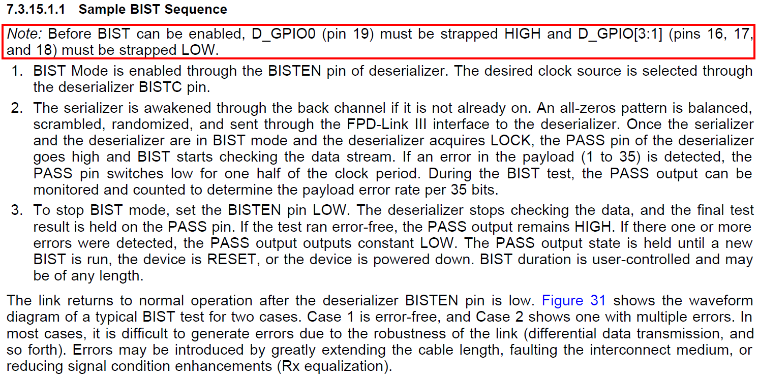

  • Hello Tomislav,
    Do you pull the GPIOs as explained in the datasheet?
    Are you following the steps exactly as described in the datasheet?

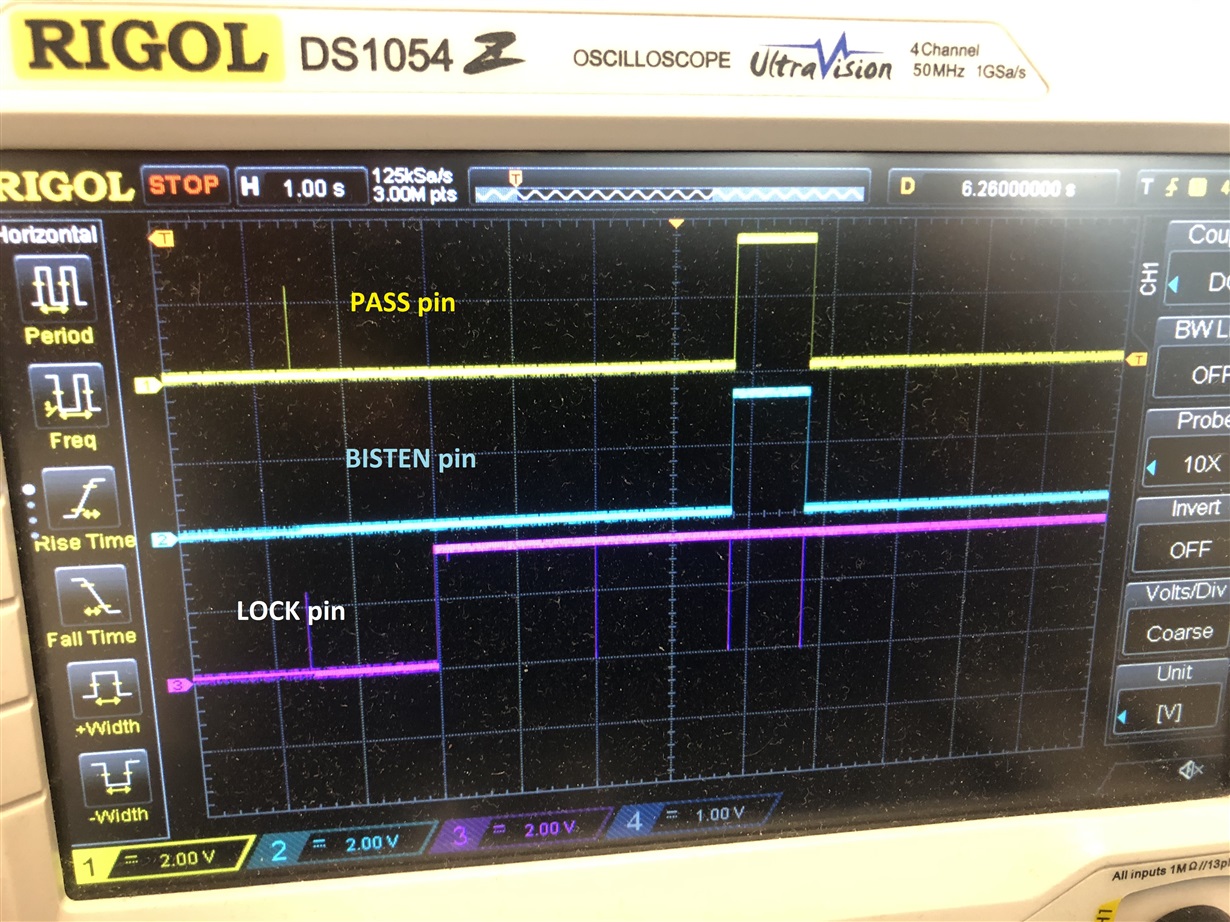

    I captured three important signals during BIST.
    Something is happening 250ms after BIST is enabled.
    I was not able to read 948 after that. Reg 0x1B in 949 has value 3 on both ports.
    Best ragrds,
    Tomislav

  • Hi Hamzeh,
    I tried with another board. The same thing happens.

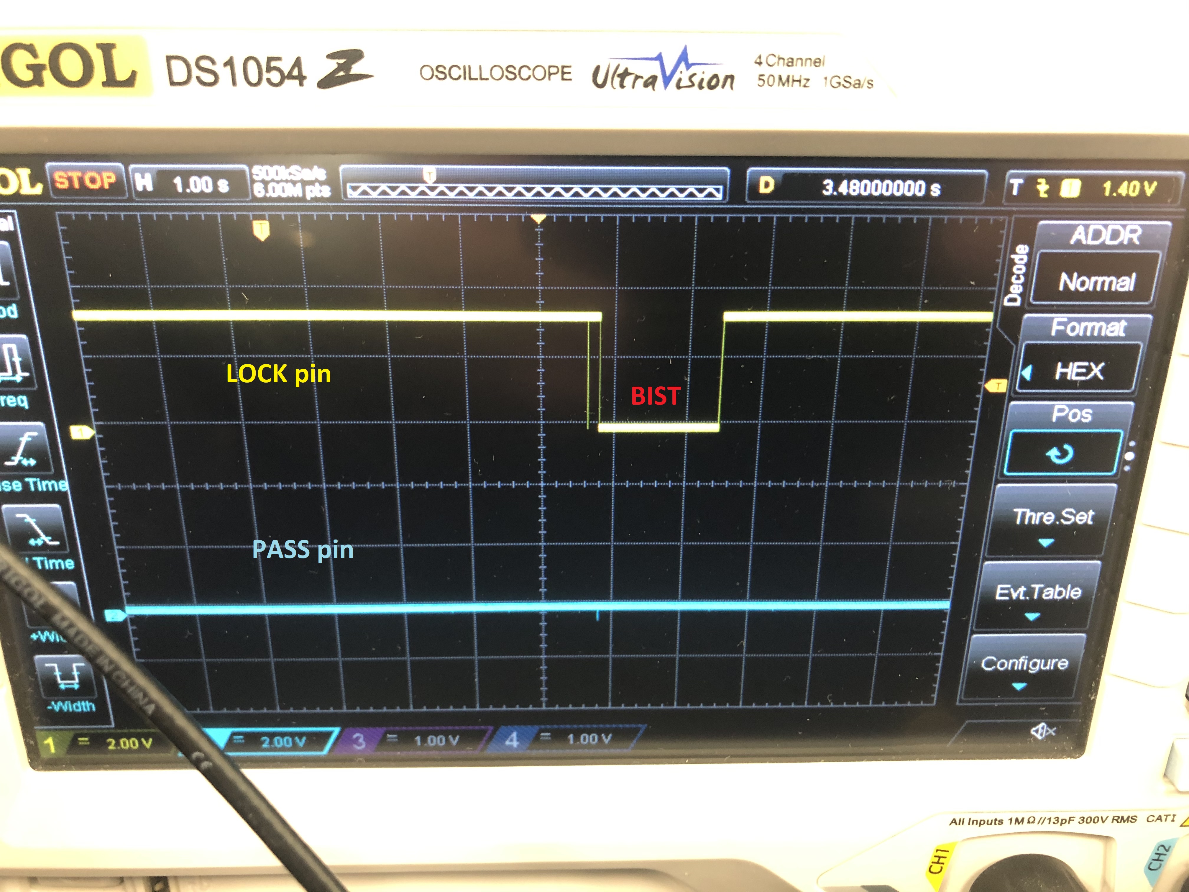

    Here is another capture. Maybe it can help you to understand what is happening.
    As you can see on starting and stopping BIST, LOCK signal is not stable in HIGH. Is that normal behavioral?
    Starting BIST(zoomed):
    Stopping BIST (zoomed):
    Tomislav

  • Hi Tomislav,
    Why is the PASSpin connected to the GPIO2 pin? Can you retry your test but with R101 removed? Also during your testing, can you have the video going into the 949 be consistent. To change video frequency or video timing into the 949, the 949 should be reset.
    Michael W.

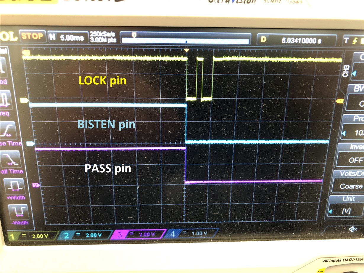

    I already sent you similar waveforms, but I do it again.
    This is what is happening during BIST. From some reason LOCK is not stable(not always HIGH) in the moment when BIST is enabled and disabled.
    Moment of starting BIST(zoom):
    Moment of disabling BIST(zoom):
    Tomislav
  • Hi Tomislav,
    The GPIO's cannot be sent across the link during BIST so connecting GPIO2 to the PASS pin will not allow you to read the PASS pins status from the serializer.
    It is expected behavior for the LOCK to be intermittent when switching to BIST and switching out of BIST.
    Michael W.
  • Hi Michael,
    I know the GPIOs cannot be sent across the link during BIST. The idea was to check PASS pin after BIST is performed.
    Regarding LOCK, a few posts earlier Hamzeh wrote that this was not the expected behavior.
    OK...if LOCK signal behaves normally, I still have a problem with communication through back-channel after BIST is disabled (BISTEN goes LOW).
    I'm not able to communicate with any device through back channel after BIST.
    Also PASS signal on deserializer after BIST is LOW and there are errors in reg 0x1B on serializer indicating CRC errors during BIST.
    Best ragrds,
    Tomislav

  • Hi Tomislav,
    Yes, I think the register dump from the DES after the BIST will be very useful. You could try soldering on wires onto the display's I2C and connect a USB2ANY and use Analog launch pad to get the register dumps for the 948.
    Michael W.

  • Hi Tomislav,
    Your EQ values are different between before BIST and after BIST. It is a possibility this is the issue. is the video working after BIST is disabled?
    Michael W.

  • Hi Michael,
    Is this the right way to enable and disable BIST? 948 and 949 datasheets say that BIST must be enabled on deserializer via register or pin.
    I tried to enable BIST on serializer with register 0x14 but I'm not sure that BIST function is started at all.
    PASS pin is low all the time as you can see on waveform...
    Tomislav
  • Hi Tomislav,
    It should be a valid way to enable BIST. Can the 949 read from the 948 after the BIST is turned off? what does the BIST BC Error Count register say after BIST is disabled?

  • Hi Michael,
    I read in several topics on 2e2 forum that BIST must be started on deserializer. 948 and 949 datasheets say that too.
    Ok. How can I check if BIST procedure was enabled? BIST is started on serializer side with register 0x14. I checked this register a few moment later and it has value 0x01 (BIST is enabled).
    But... LOCK pin on 948 is LOW as long as BIST is enabled, as you can see on image I sent you in the last post. That is probably not a good sign. Also PASS pin not changed at all, so I doubt BIST procedure was not started properly.
    BIST BC Error Count register is 0 and I can read 948 after BIST is disabled, but I think BIST was not started on deserializer side. It seems like that.
