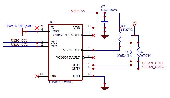

I would like to get your assistance regarding our customer issue with their design using TUSB321.
They use TUSB321 in UFP mode, but it can't detect the current mode from the upstream side, and always report the lowest current only whatever the power source is.
Here's part of the schematic. Please let me know your inputs and questions.
Thanks.
Jonathan

    According to the customer, their field engineer report they use a 3A wall adapter, type C-C cable connected to UFP device with TUSB321 on it, the CC lines measured voltage are 0V/1.3V on same side of TUSB321 located, and the OUT1=H, OUT2=L, which means 0.9A/0.5A current rating detected.
    Another Question: if the wall adapter side just have a simple 10k pull up to 5V, will TUSB321 driving CC lines to different voltage at different time to detect the current rating ? or the CC lines should be stay on a voltage in this case ?

    When TUSB321 is configured as a UFP only Rd is presented on the CC pin. The CC voltage is only monitored to update the OUT pins. The CC voltage should be consistent in the case when Rp and Rd are connected. I believe that TUSB321 is connecting in dead battery mode and OUT pins are reflecting default current advertisement. Can customer trying testing with external power supply to TUSB321?

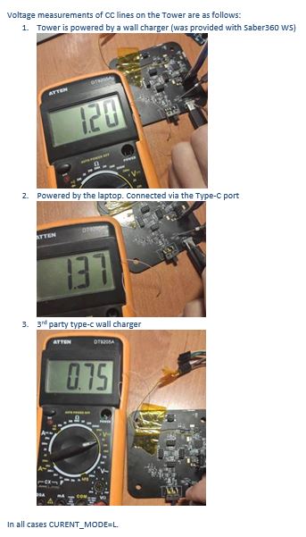

    By the way, here's the image for their measurement.
    Looking forward to your comment.
    Jonathan
       You can see we have different voltages (from different power sources) shows on CC line to the TUSB321 device, but we haven't see any difference output from TUSB321.

  • Our power adapter supplier share their schematics to us, and it support PPS,PD2.0/PD3.0,QC3.0/QC2.0,FCP,SCP, AFC, Apple 2.4A,BC1.2, and we also noticed the CC line changes, the problem is the TUSB321 can't do his job to report the capability of power, always say it is 0.9A/5V power source.
    Since TUSB321 is powered by Vbus, all connections will be made under dead battery mode. In this mode TUSB321 will no be able to report the advertised current mode. Are the results reported above tested with TUSB321 power from external supply or Vbus (Vcc > 0v)?

    In your schematic you have TUSB321 powered by Vbus. Before a connection Vdd will be 0V until connected DFP see Rd (from dead battery mode) and enables Vbus. Are you saying that Vdd is externally powered in your testing or is Vdd powered from a Vbus that is always enabled during testing?
    Dead battery mode is described in TUSB321A datasheet, TUSB321 also includes this feature.
  • That is correct, dead batter mode is entered when VDD is 0V. If a constant 5V still results in the same behavior then it is possible the device is being back driven by the 3.3V rail pullup on OUT1/OUT2. Please make sure 3.3V goes high after 5V Vdd is stable.

  • I did another test with VDD (5V) applied before, same time and after the type C cable connected, all of them report same lowest current, whatever the host side is.

  • This is not expected. Powering 3.3V before 5V can cause the internal to enter a bad state. 5V should be stable for at least 2 ms before 3V is stable. You see this issue on two platforms correct? Have you tried replacing the parts with new devices on the no good platform? Also from your testing, do you have a waveform with CC1, VDD5, 3.3V OUT1 (assuming only 1.5A advertisement should be detected).
    Is it possible some other device is holding down OUT2? No sure since there is only a partial schematic.
