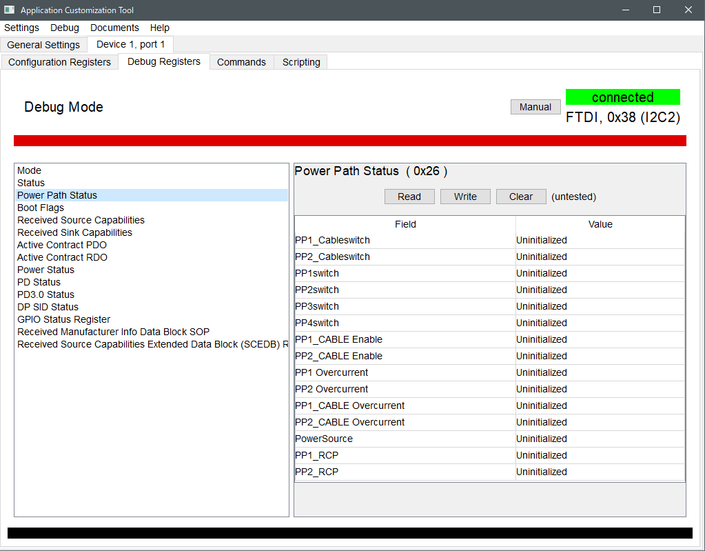

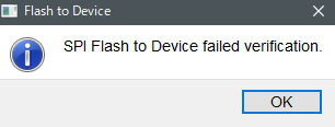

(1) When I read the SPI FLASH firm and check it, the firm version is incorrect as shown in the following image.
When I check it in debug mode it seems that all the settings are not written like the second image.

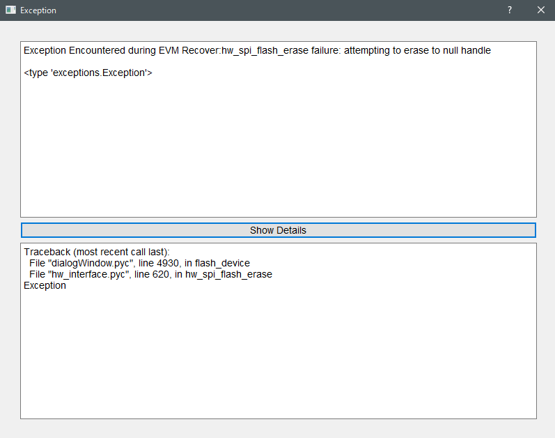

(2) When trying to execute "Re-Flash EVM Firmware (Recovery)" to solve (1), the following error is displayed.
Also, even if the template is written in "Flash from current project", the writing fails.

    In the second image, the settings are not written because you did not hit "read". If you notice right below the register, there are three buttons, "read" "write" and "clear". Please press read to see the settings you've flashed to your device. For more information on debug mode, check out this video: https://training.ti.com/tps6598x-gui-tool-displayport-alternate-mode-debugging .

    Another note, GUI 6.1.1 has a bug with the "Re-Flash EVM Firmware (Recovery)". It will be fixed in the 6.1.2 release. The "flash from current project" should work, however, so let's continue to debug your issue.

    As a result of reconfirmation, "Sweep I2C address range" fails while supplying 5V with the AC adapter. On the other hand, if 5V is not supplied, the address will be
    0x00 to 0x7f is detected.
    Similarly, in the debug mode, the connection availability changes depending on the presence or absence of 5V power supply.

    As a result of exchanging the microB USB cable for I2C communication,
    the address was detected correctly and it was possible to write to Flash.
