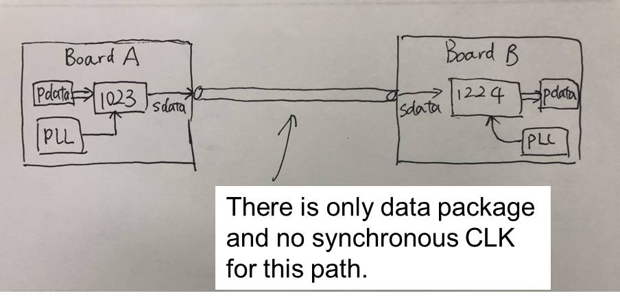

Hello Sir,
One of my customers met error issue of SN65LV1224B. Do you mind helping on a view?
There are two kinds of error phenomena: 1) the lock signal is high; 2) the lock signal is low, but the data is wrong;
2. Customer uses SERDES for inter-board communication, SERDES only transmits communication packets, without an attached clock;

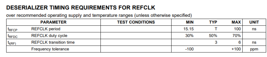

3. Tried to modify TCLK_R/F, this is the result after modification, it is worse before modification;
4. The TX and RX differential pairs have been checked, and the wiring has equal length rules;
5. The conditions are limited and it is impossible to observe the differential signal of transmission;
Customer expect:
1. Locate the error problem;
2. Solve the error code problem through software, or reduce it to a minimum;
3. More details or precautions for chip usage and configuration;
4. Provide more reliable design guidance;
