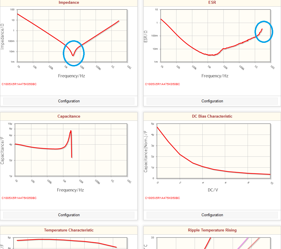

For SDI interface ICs, AC coupling is needed at SDI inputs/outputs.
Generally, a 4.7uF ceramic capacitor in 0402 footprint is recommended.
Nevertheless, MLCC capacitors with high value exhibits a rather low (in the MHz range) SRF, with impedance + ESR going rather high on beyond 1GHz.
Here below, the performances graphs for a typical TDK reference commonly used in TI boards.
Is this a non-issue, or an unavoidable evil?
should we try to piggy-back a smaller capacitor on top of the 4.7uF one?
  • Greetings Renzo,
    Frequency of interest is at about 6GHz. This is because this is the nyquist frequency at 12G SDI. At this frequency impedance is about 5 ohms. This has not caused performance issue or side effects in two areas: Firstly, device passes return loss with margin. Secondly cable reach is as expected. We would have preferred to use a cap that has lower impedance at 6GHz however cost and availability caused us to use this cap. You are welcome to use a better cap or a lower impedance cap and compare return loss using either one of these two parts.
    Regards,, Nasser
  • Dear Nasser,
    thank you for your reply. As I read your answer, it seems to me that the impedance if this capacitor - given the required high value and small footprint - is an unavoidable evil, anyway not causing great issues.
    I was just puzzled that no one seems to have noticed this.
    Fine for me, I am reassured.
    Thank for your support, kind regards
    Renzo
