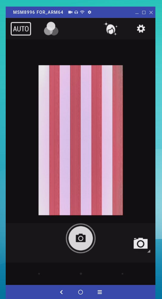

DS90UB953-Q1: Issue with TPG generation
Part Number: DS90UB953-Q1
Other Parts Discussed in Thread: DS90UB951-Q1, DS90UB958-Q1
Firstly, my actual part number is DS90UB951-Q1 which is not in the list. Hence using the nearest cousin. Apologies for that.
I am trying to generate a Test pattern from Serializer with the following configuraitons
- 3848x2168 (4K) resolution @ 30fps
- RAW12 data type.
I have attached the register configuration that I am currently using (The CSI Enable will be set at a later point in code)

The same configuration works for deserializer as shown in the below image (Ignore the color as it is done by incorrect post processing)
However, When I apply the same register configurations for Serializer, I get something completely different. It looks like below images
 https://lh3.googleusercontent.com/-I0hbpM7lwio/X38oZxGxTBI/AAAAAAAADF4/Bi_8rn1vKikYmvN6Mf6DpbmBmqXK9DQPgCK8BGAsYHg/s0/2020-10-08.png
When I dumped the Registers from (0x4C - 0x7F) of my DS90UB958-Q1 deserializer during streaming, I see that there are a lot of errors on the Channel. Attached the logs for reference

Could someone shed a light on what the issue might be?
Please let me know if anything else is required.
