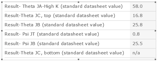

What is the Theta_JC value of DS90CR217MTD?
Thanks.
It is 16.8 to top.

Hello, is there a value of Theta JC bottom?
I am trying to determine the Theta JB as the sum of Theta JC (vendor provided) and Theta CB (calculated based on lead length, cross-sectional area,
and number of pins). I would like Theta JC bottom to accurately determine a Theta JB value and know top =/= bottom based on the internal design of the part. Thanks.
