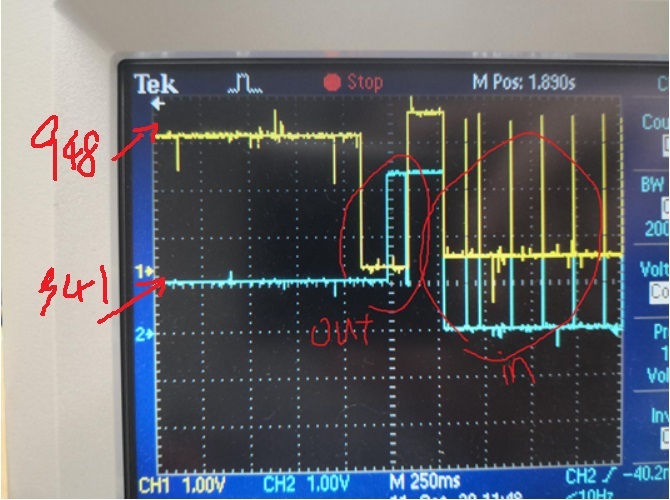

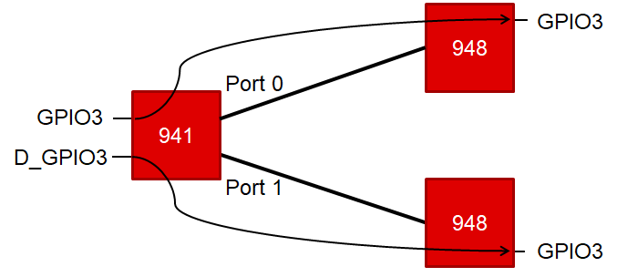

  we use one 941 connect with 2 948 for 2 display:
941’s GPIO0/1/2/3 to  first 948's GPIO0/1/2/3 and 941's D_GPIO0/1/2/3 to secont 948's GPIO0/1/2/3.
set gpio3 output,  then we set high on 941's D_GPIO3, but 948's GPIO3 not be high;
but after set gpio3 input, we see 941's D_GPIO3 change follow 948's GPIO3.

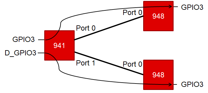

    Are both 948's locked and receiving video data? Is the port 0 of both 948's connected to the 941AS?
    Michael W.
  • Hi Michael,
        Thanks for your help!
    yes, we connect 941 with 2 948( 941's GPIO* with first 948's GPIO*, 941's D_GPIO* with second 948's GPIO*)
    sorry for mistake in attachment.
    I dont see a problem with your script settings. Can you give me a reg dump for the 941 and the 948's?

    Can you please try implementing this procedure and see if it fixes your issue?
    •Write( 941, 0x1E, 0x01)
    •Write( 941, 0x0F,0x03)
    •Write( 941, 0x1E, 0x02)
    •Write( 948_port0, 0x34, 0x01)
    •Write(948_port0, 0x1F,0x05)
    •Write(948_port1, 0x34, 0x01)
    •Write(948_port1, 0x1F,0x05)

    and threre are some question:
    •Write( 941, 0x0F,0x03)          // i set 941 0x1E to 0x4 for both enable 2 948,  is it ok?
    •Write( 948_port0, 0x34, 0x01)    //second 948 used GPIO0~3, not DGPIO0~3,  so turely PORT index (0x34)on second 948 should be 0 or 1?
  • Hi
     "i set 941 0x1E to 0x4 for both enable 2 948,  is it ok?" you need to set both the D_GPIO and the GPIO separately.  you could write the 0x1E to 0x04 but you would need to configure the D_GPIO(0x0F) from the other I2C address.
    Settig 0x34 sets the port select to write to port 0. "second 948 used GPIO0~3, not DGPIO0~3,  so turely PORT index (0x34)on second 948 should be 0 or 1? " can you clarify your question.
    Michael W.
  • on early discuss, i checked both value 0/1 on reg 0x34 of 948;
    after setting register 0x34 to 0x0 on 948 side, then we can not read GPIO status of 948, please help to check.dump_before_setting_D_gpio3_input_port0.txt
    please help to check our dump register and initial code earlier;
    You need to select which port that you are reading the GPIO status of meaning that 0x34 must be either 0x01 or 0x02 to read the GPIO values.
    Michael W.
