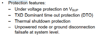

Additional questions.
The protection features supported by TLIN1022-Q1 are specified in Datasheet as shown below.
Does TLIN1022-Q1 have other protection features & diagnostics?

    I don't believe this is a result of device modes or protection. TLIN1022-Q1 will only enter sleep mode when the EN pin input is low. As long as the enable pin remains high, the device will remain in normal mode (as long as there is no undervoltage condition). There is no specific mode to handle a bus fault event. As this device can tolerate 36V (recommended) at the bus pin, a battery fault would not trigger any active or passive protection.
