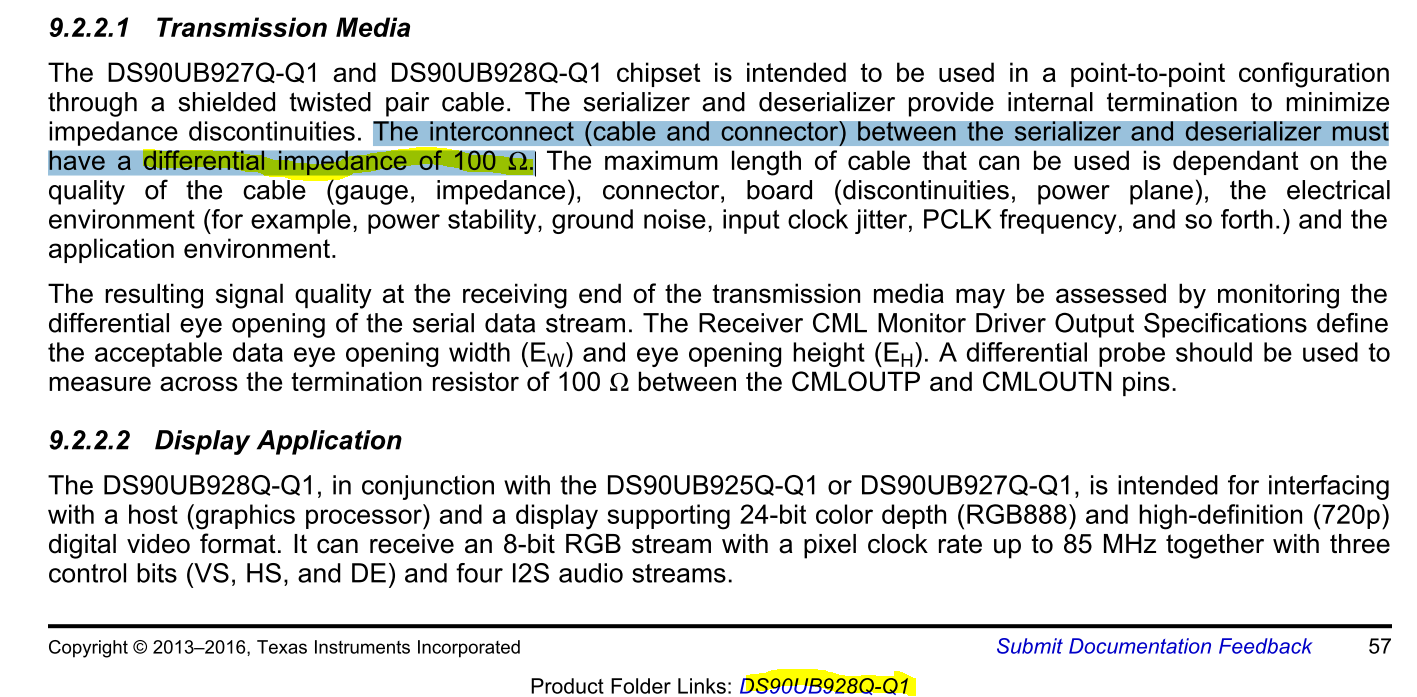

Hi Team,
What's the tolerance of the differential impedance (100 ohm) stated in the datasheet? Is it +/- 10%?
Thanks!
Roy
Roy,
For the trace, the typical diff. impedance variation is 5%and the worse is 10%. in the connector, the typ. diff. impedance varaition is 10% the worse is 15%.
