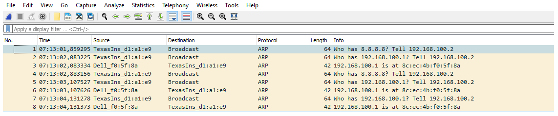

  • Hi Justin,
    thanks for feedback. Customer:
    "the Linux host (AM3358) can send Ethernet packets over the RGMII interface but does not receive/handle incoming data.
     -We connected the DP83822 (EVM) with the OSD3358 (internal AM3358) and have the Linux driver and device-tree operational.
    -From the Linux host (on the OSD3358) we can send out a ping (Ethernet transmit) to my Windows laptop and the laptop does correctly respond.
    -However the Linux host does not receive anything of this response or other received messages.
    MAC TI AM3358: 98:5d:ad:d1:a1:e9  192.168.100.2
    MAC Dell laptop: 8C:EC:4B:F0:5F:8A 192.168.100.1

    Wireshark laptop:
