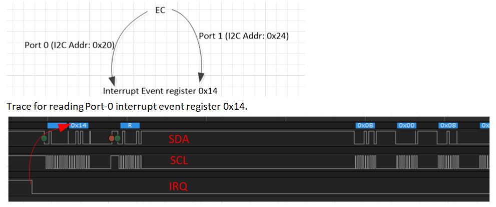

    At a high-level, the I2C interaction is based on interrupt events (INT.EVENTx you can find all available events in TRM). PD controller assert IRQn signal when the interrupt event occurs (to alert MCU). MCU shall read interrupt event registers to identify and clear the interrupt event.

     2. Identify interrupt event and port by reading 0x14 (I2C1)
    0x14 IntEvent1: Interrupt event bit field for I2C_IRQ1 (output is low if any bit in this register is set).
    Read interrupt event register 0x14 of both ports to identify interrupt event and interrupt source (Port-0/Port-1)

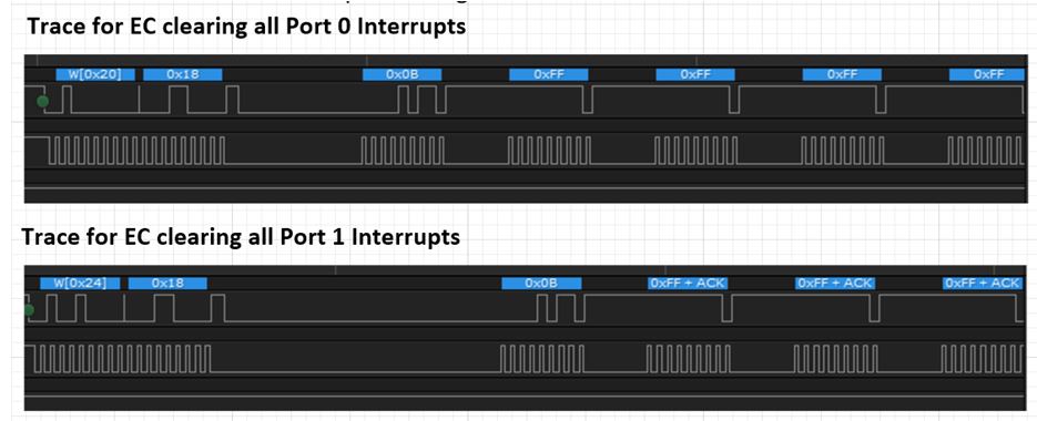

    3. Clear interrupt
    //clear interrupts
    0x18 IntClear1: Interrupt clear bit field for IntEvent1. Bits set in this register are cleared from IntEvent1
    uint8_t     indataclear[MAX_BUF_BSIZE] = {0xFF, 0xFF, 0xFF, 0xFF, 0xFF, 0xFF, 0xFF, 0xFF, 0xFF, 0xFF, 0xFF};
    retVal = WriteRegP1(pData->clear_reg, REG_LEN_INTCLEAR1, &indataclear[0]);
    RETURN_ON_ERROR(retVal);
    retVal = WriteRegP2(pData->clear_reg, REG_LEN_INTCLEAR1, &indataclear[0]);
    This code snippet shows how to clear all interrupts. Similarly, you can selectively clear an interrupt after that particular event occurs.
