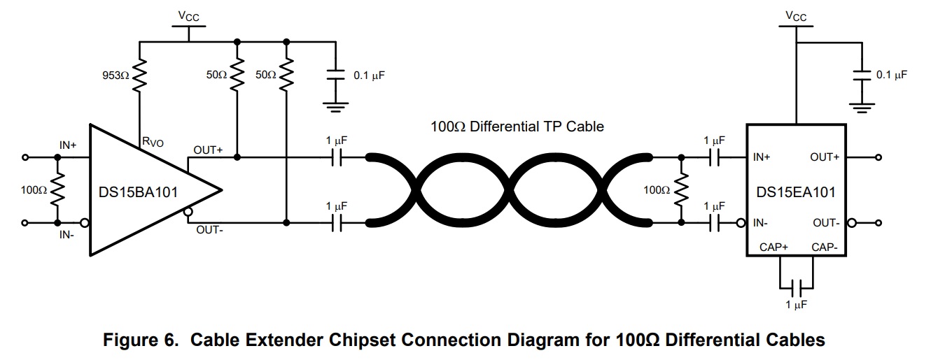

I have a question about termination resistor in fig.6 for DS15BA101.
Is it possible to put this termination resistor after the capacitor?
I want to put a termination resistor near the IC.
