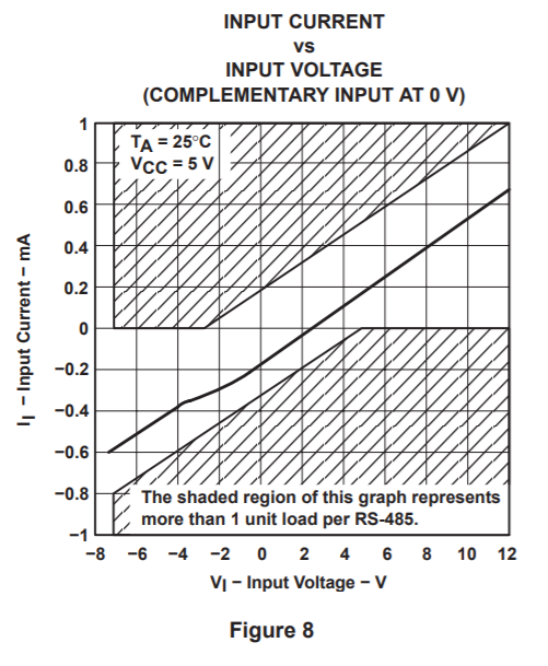

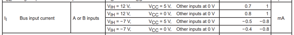

    If you are looking for input current loading on each node (including worst-case/maximum values), then this information should be helpful:
    For a voltage-current characteristic of the input nodes of the device (i.e. conductance characteristic or inverse resistance) you can use this plot:

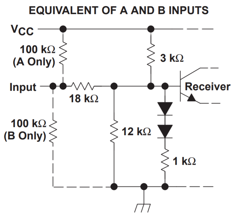

    And for a reference equivalent schematic of the input pins, including relevant impedances, this should be helpful:

  • Bhargav,
    I have spoken further with other team members and confirmed that the bus input current should serve your needs for determining bus loading. The maximum values would serve as the worst-case (i.e. minimum resistance).
