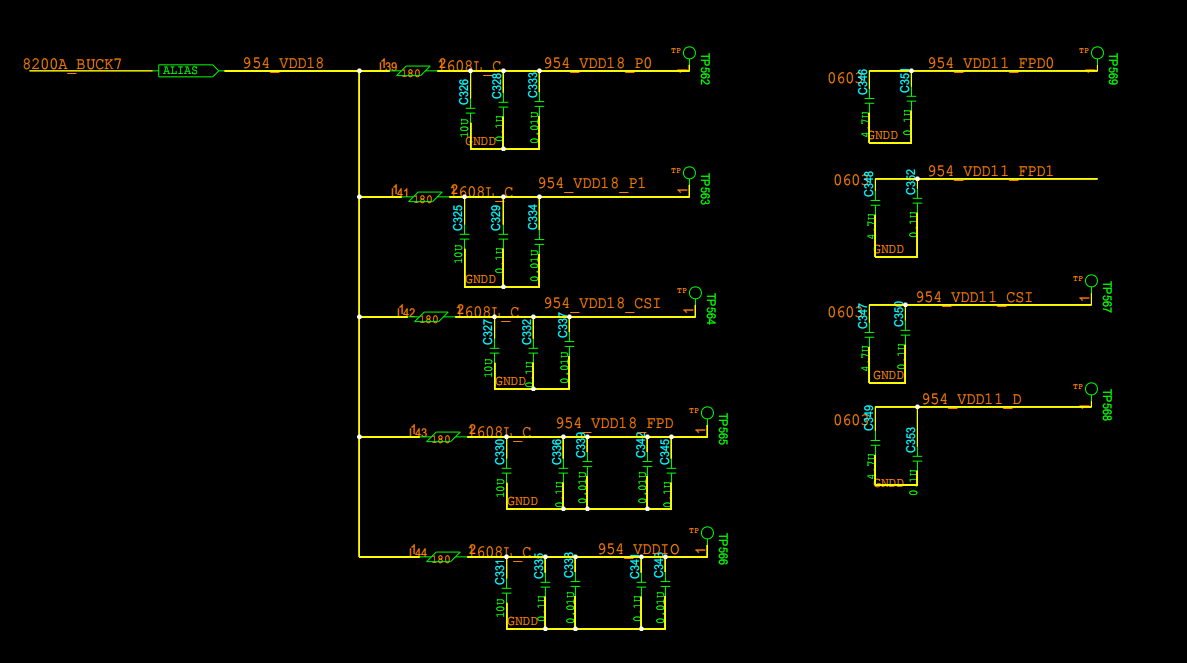

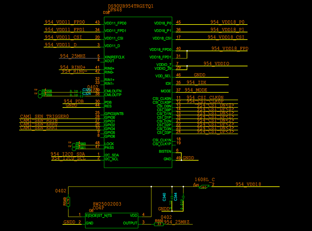

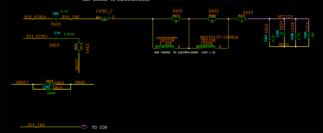

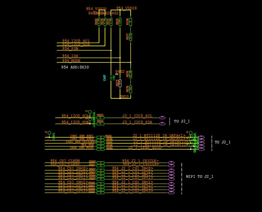

Hi team,
The following is the related schematic diagram of DS90UB954TRGZTQ1. At present, the cpu can only read the device address 3d of the 954, but cannot read the address of the front-view camera (the front-view camera is connected through the poc circuit). Does the cpu need to do anything with the DS90UB954TRGZTQ1?
