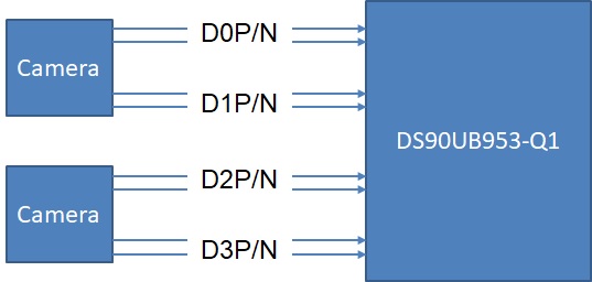

Is it possible to do a system that inputs two cameras to the DS90UB953-Q1?
The configuration is as shown in the figure below.

this configuration is not possiple because you just have one CSI-CLK pair and this can be connected to just one image sensor.
You may add a switch between the two sensors and switch to the required one.
