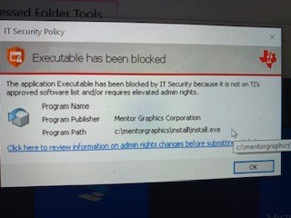

do you have *Brd file? I can't open PCB file.

Hi Brian,
would you please use the layout viewer to review the layout?
thanks a lot,
SHH
Hi Brian,
sent ticket to IT, you will be able to install this SW.
