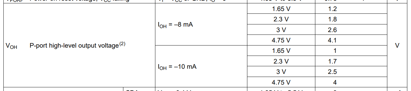

SHH,
The note on the schematic is correct that these I/O ports are 5V-tolerant. An input VIH of 5 V will be recognized as a logic high even with a VCC of 3.3 V.
However, I noticed that a few of the net names for certain outputs indicated that they connect to 5V I/O pins downstream (e.g. 5V_OT2211_EN and 5V_F75501_EN). Note that the high-level output voltage VOH for a P-port output is dependent upon VCC.
Since this TCA9555 appears to be powered with a VCC = 3.3 V, it is important to ensure that the resulting output voltage VOH of these pins meets the high-level requirement of the downstream devices. I'd expect VOH(min) to be somewhere around 2.6 V to 2.8 V.
Danny
Hi Danny,
thanks for feedback. customer confirmed VOH(min) to be somewhere around 2.6 V to 2.8 V is ok.
