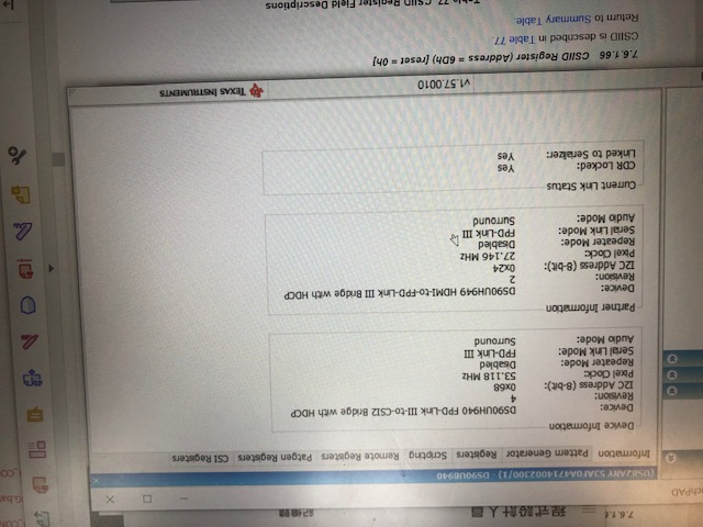

Hi
We are using DS90UH940 to connect DS90UH949. At 949 side it take in 720P video.
At 949 side we see correctly 27 MHz the pixel clock but at 940 side the pixel clock become 53 MHZ.
Would you help review our register dump of 940 and 949 attached below, and help advise where might went wrong ?

the resolution capture by analog launch pad see it become 1440 x 480
  • Hi PY,
    Are you trying to get the pattern generator outputting to the display for 1920x720? Do you want to display from 940 patgen or from 949 to 940. If it is, you need to do this on the serializer side UB949 by selecting the timing source "Internal" and HD 720P 60Hz.
    Let me know if you have further questions.
    Aaron
