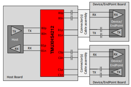

Quick question, do you know if any method to pair with 1pcs DS90UB933 to 2pcs DS90UB934?
Is it feasible or any limits?

Hello Ted,
if you use 1:2 HS switch at the SER output, you can have two Fakra connectors in the camera, connected to two different DES.
HI Jaradat,
Do you have more details on how to implement this?
What's the 1:2 HS switch?
Have you test this and it's workable?
Hello Ted,
This is a High Speed 1 to 2 bidirectional switch.
I have not tested this, but you may contact the responsible group if you need support from them.
For more details, you can check the datasheet of this switch.
