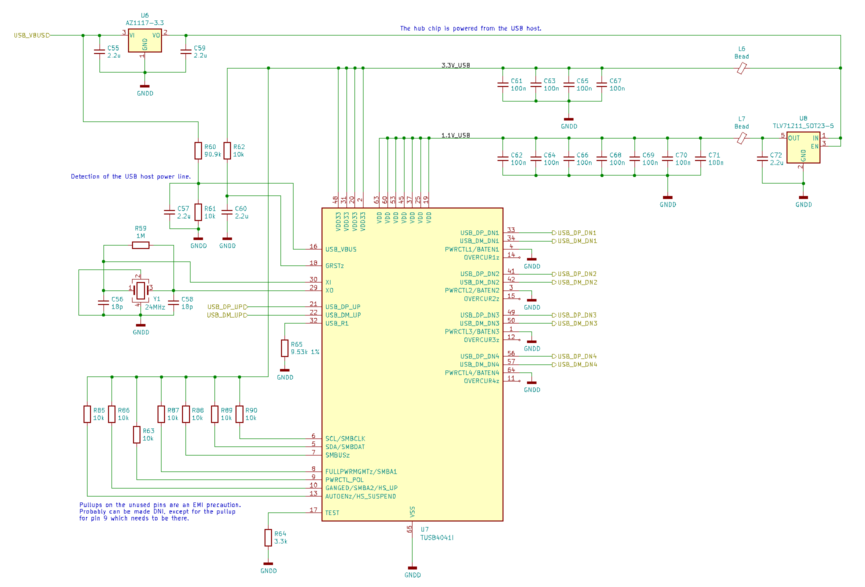

The reset pin is connected to an RC circuit with time constant of about 20ms. Manually pulling down the reset pin after the device was not recognized does not help. Also power cycling without disconnecting the USB lines does not help.

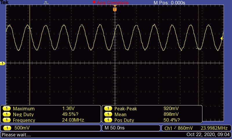

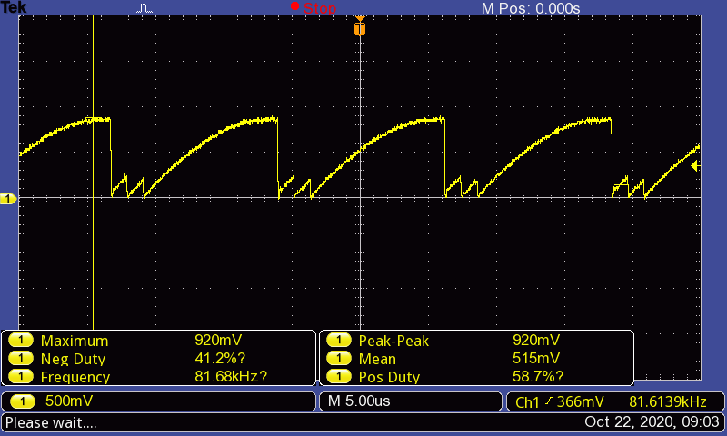

After some troubleshooting I noticed that the clock oscillator behaves strange when the system is not recognized, so I tried to tackle it there. One of the attached scope screenshots shows the strange behavior on the clock, and the other screenshot shows a nicely operating clock when the same device is connected to the same host via a USB hub. The signal is measured on one of the pins of the crystal. Note the different time scales.
The crystal used is ABM3B-24.000MHZ-10-1-U-T. I tried the following steps to see if I can make it work:
- Remove the 18p caps
- Put the caps back, remove the 1M resistor
- Put the 1M back, add a 1k resistor in series with the XO pin
After each of these steps the device was working just fine via an external hub, but did not work without (i.e. the steps taken had no effect at all, also did not make it worse).

  • I have an update. I took two boards, one was working as expected and one had the described issue. I swapped the TUSB4041 chips between them. The problem follows the chip, i.e. the chip is damaged.
    Now the question is, what could cause such a strange damage to the chip? We do have ESD protection on all of the USB ports, and in the final product the ports are rarely disconnected anyways. What could cause the chip to stop working with only some of the hosts?
  • Hi Karol,
    That clock looks very strange, typically a damaged port just won't connect and we don't see any impact on the oscillator circuit.

  • Hi Karol,
    I would expect an ESD damaged device to just hard fail, not degrade.  Is there any chance the solder connection between the thermal pad and the ground is degrading?   Since VBUS isn't routed directly to the hub, only through a divider network, the pin mating order is not a major concern.
    Now that I'm looking at your schematic again, I see a few things I would recommend changing.  Remove the pullup on GRSZ, there is an internal pullup (~22K) on that pin and adding an extra one will just shorten the expected reset.  I would also recommend removing the pullups on SDA/SCL too.  The hub will enter a programming mode if it sees a blank EEPROM installed, this shouldn't happen with just pullups on SDA/SCL, but it definitely won't happen if they are unconnected with the internal pulldowns.

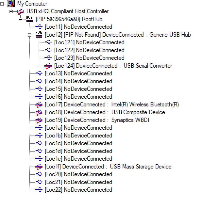

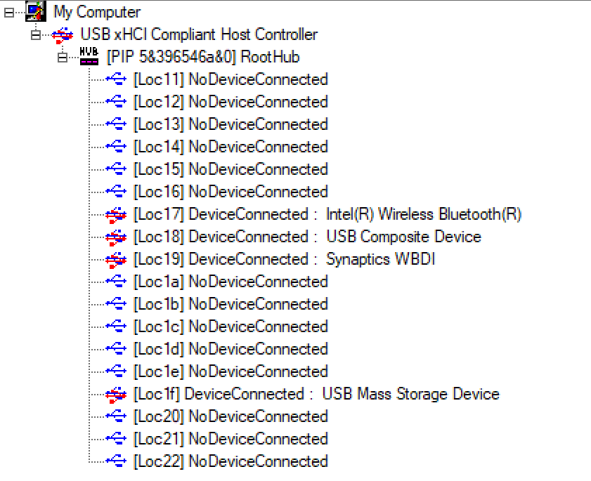

    I connected the boards to a Windows 10 laptop and ran usbview as you requested:
    - A working board reports a 4-port USB hub. On that particular PCB there is also an FTDI chip hardwired to the hub, so one of the ports reports that.
    - A board that doesn't work is not shown in usbview at all, connecting it does not cause anything.
    - A board that doesn't work that is connected via an additional Logitech hub is shown as if it was just fine. On that one there is no FTDI chip, so all ports are free.

    Working device:
    Not working device connected directly:
    Not working device connected via Logitech hub:
