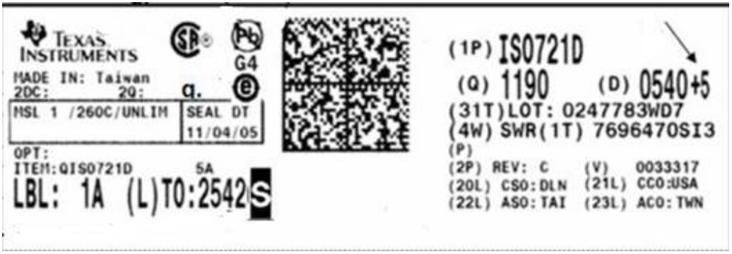

    For any product, if you’d like to locate the Internal Manufacturing Shelf Life, check the packing label (shown below). A “+5” would indicate an ESL product.
    Note that TI’s internal manufacturing processes are carefully controlled to deliver products with appropriate minimum Customer Shelf Life, so its internal manufacturing shelf life should be irrelevant to an end-use application.
    Also, this part is MSL1, so it has unlimited floor life. I mention this just to say that floor life has no impact on shelf life for this product.
