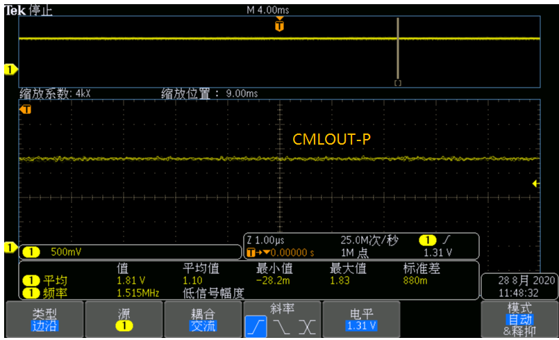

  • Hi Jiashow,
    The VDD18 signal has been measured by an oscilloscope, without noise;
    913’s POC network has an inductance of 100uH;
    The CMLOUT pin signal was tested, as shown in the figure below:
    Customer would like to know how does he manually adjust the equalizer?
    Annie
  • HI Annie,
    What was the noise measured on the VDD18? Did the customer add decoupling caps?
    The customer should use a differential probe to check CMLOUTP and CMLOUTN pins. THey should see an eye diagram, not a DC voltage. They can bypass AEQ in reg 0x4D and manually set it in reg 0x04.
    Jiashow
  • Hi Jiashow,
    The lock is still unstable since I've tried these suggestions.
    signla of CMLOUT pins looks bad as follows:
    BTW, the same 913-module works well with another board witch uses 954 for DES.

  • Dear Jiashow,
    We don't have differential probe. there seems to be no noise on the VDD18.
    I tried to bypass AEQ and adjust the value of 0x04, the phenomenon keeps the same.
    I will ask my hardware engineer to  check the impedance/s-parameter of the board first,and then refer to U for more help.
    Tianyu
